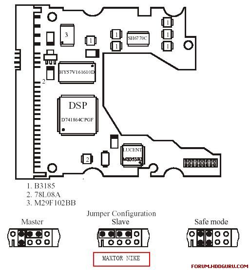

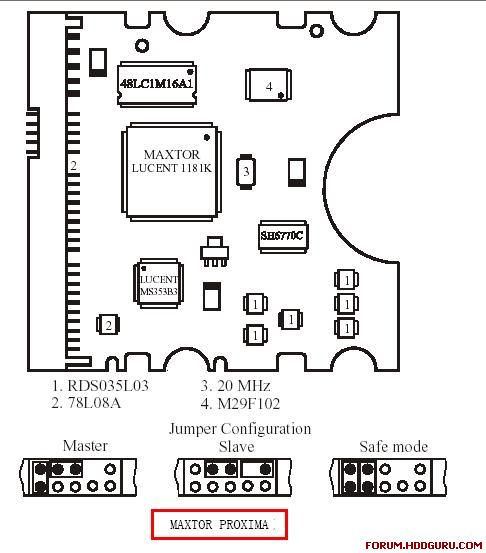

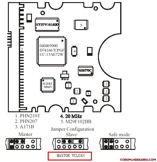

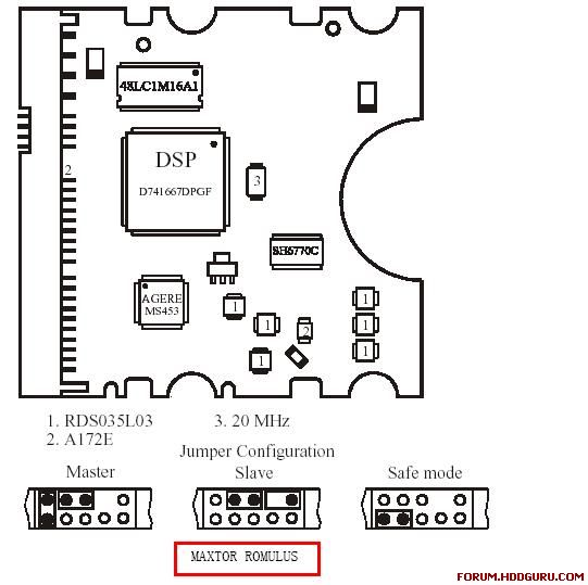

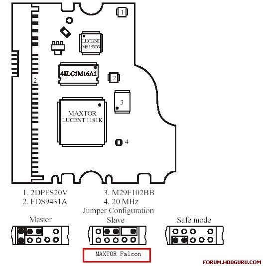

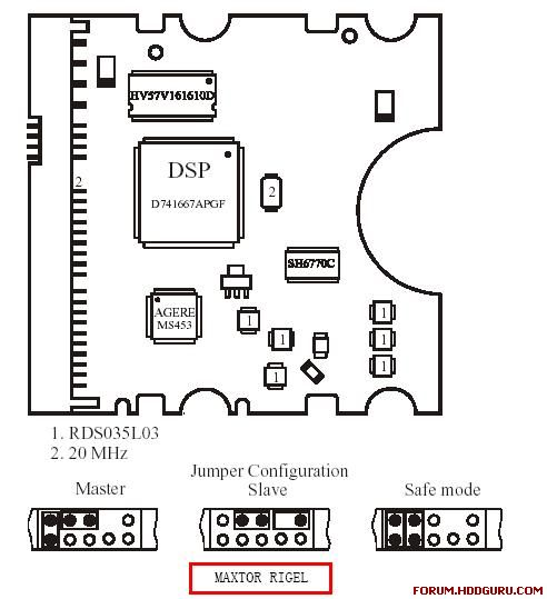

 Post subject: All Maxtor Safe mode ;)
PostPosted: May 19th, 2007, 5:02
Joined: May 19th, 2007, 4:07
Enjoy :)
 Post subject:
PostPosted: May 19th, 2007, 5:08
Now can u plz help me fix my N40P ? wot do i need exactly ? and how to do that !! Im really tired of lookin everywhere without any clear detailed explanation.. :?
