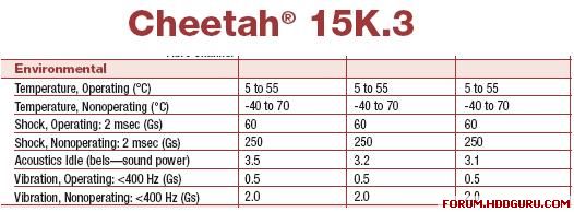

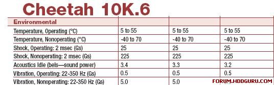

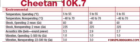

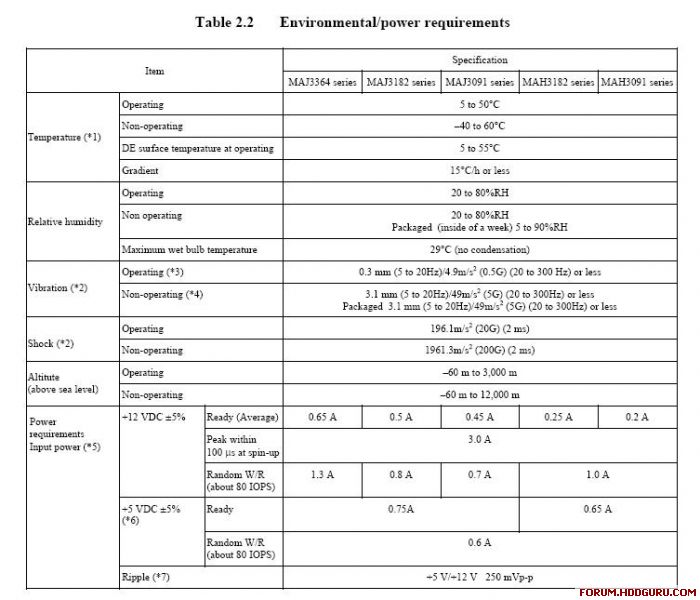

What is the specifications of shock or (G's) that a SCSI drive can withstand.
Each manufacturer and drive are probably different but they should be close.
Thanks for any help.

I hope this could help...
DataRecovery.bg

Thanks Samo.
I have found a few others and they all seem to be around 200-250.
Anyone with a few more I would be greatfull for them.
