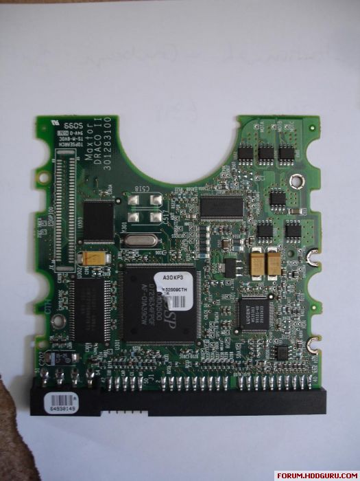

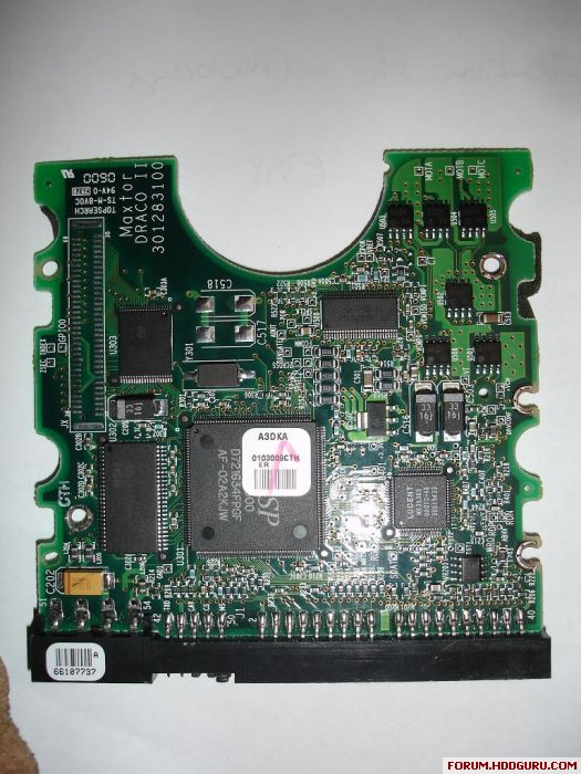

I have tried MHDD as you suggested but it does not find the drive, in a PC with no other hard disks present. Also tried enabling the primary etc.
I can hear and feel the drive spinning up with the donor card, plus it gets warm (but not hot).

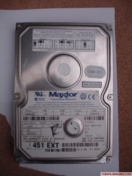

The problem drive is the one below.

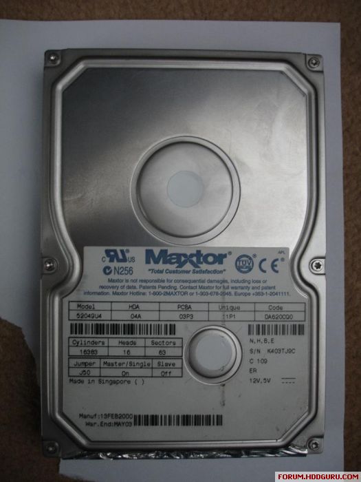

This is the drive i used as a donor
Here is the damaged (not working at all) card
Here is the donor card
basically I am not sure what the problem is. I was told it was likely to be firmware but as HDDGUY said, how do I know for sure that it is?
I was told that I needed to match the drive model number and also the number under CODE on the front of the disk, as this is the firmware reference. But as you can see, the PCBA and UNIQUE codes are not identical. Does anyone know what these codes represent?
I have e-mailed maxtor a few times but only get generic answers that are very vague and point me to their website (the standard link for their support/download section). So no joy there!
Although the cards are very similar some of the chips do have different numbers/references on them. Are these uniquely different enough the stop the drive from being accessable?
