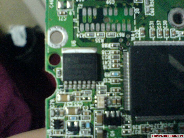

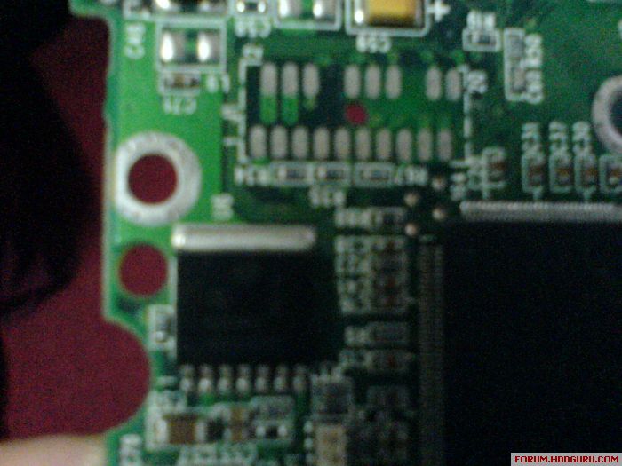

i want to ask question about 2060-001130-012 some of it have ics called IQR
(IRU12395c
cp-0406
A3c06f36)Image
and Some have
Sk410
(TLE4417
VC416123p05)Image
this ic what is job?and can IQR replace By Sk410 and visa versa >>if some member have Info About it Share It,,thanks

IRU1239SC / TLE4417 -> Fixed LDO Linear Regulator
IRU1239SC and TLE4417 are compatible...
IRU1237SC - similar but not compatible part...
