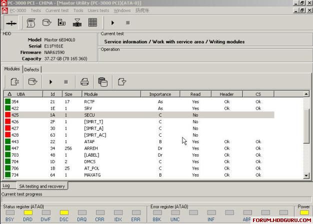

hi all
i found those pictures at another forum, i think its useful,but, how to change uba for maxtor hdd? can someone help me?
thanks in advance

u can not change UBA for a specific module . Also why do u need to change it ?

Samo wrote:
For data recovery purpose.
Is this really possible ? I cannot figure out how... :(
 Post subject:
PostPosted: June 8th, 2007, 11:53
Posts: 637
Location: Canada
Interesting...
On Maxtors there is no DIR module you can modify to change location of the desired module as in WD for example...
Roadmap on Maxtors is hardcoded into code and I never seen someone change it. But that would be a useful thing to know...
Just asked Sergei from Acelab (developer of Maxtor utility), he doesn't know either.
wawalab, what forum this is from? Maybe there is some explanation there?

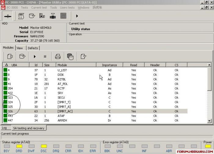

hi Starling its true
i found it in one chinese forum but without explain.
i found those UBA address like 525,426...store at module 4F,RAM, and LDR files. you can search them by hex use winhex or open those module to find, but i cannt realize it. so, Samo ,do you have ideas?

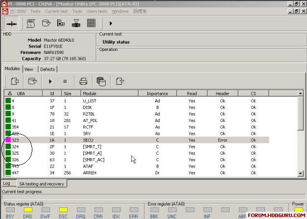

i try edit module 4F ,but havent result.
and edit modele 1A(01A90001-01450001) then rewrite,but despond :cry:

wawalab
The idea work quite well. You miss something probably.

 Post subject:
PostPosted: June 9th, 2007, 3:24
Posts: 4806
Hi Samo
I changed the location of the DISK module in 4F, it had no effect of drive initialisation. But in the utility it showed the new location which I have not written a correct DISK module intentionaly to see the effect.
Drives can work in normal mode even if these ovly modules (withing 4F) are damaged, so the solution should be somewhere else, I must agree with Starling, but I would welcome any hint of course :)

Hi Pepe,
to be 100% honest you are right! The drive can work even some parts of the 4Fh module(s) is not functional. That 4Fh hold a table of the occupation of SA modules and groups. Same that is outputed by ACE, HRT.... That table can be easily manipulated to receive the desired effect, i.e. the pictures on the top. :) But the modules isn't dependent of the occupation written within. At least that one responsible for drive operation. Something more, the mod 4Fh seens to have much more relation to the selfscan tests, status....
Selftest FAILED; SELFTEST DONE......
but this of course it is only my oppinion!
As far as we interest more of DR I must confess that I can only suppose where those table/s(if they are tables at all) are. :oops:
