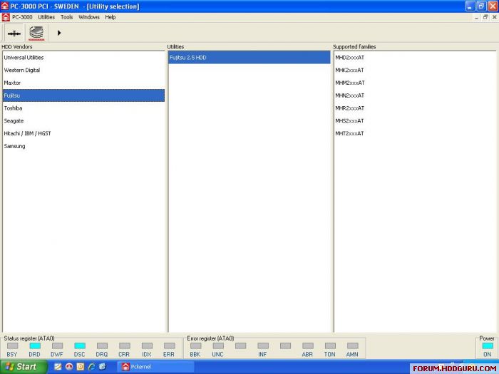

Thanks for all your input.
Doomer, how can I check the SA, when I can't get the drive to ID....and therefor can't launch the utillity?
I got the 2.27 and it can just handle Fujitsu drives up to MHT...or?
When I start the drive there is the usal small ratteling sound for the drive to become ready.
after that....nothing, just spinns.
Bosse

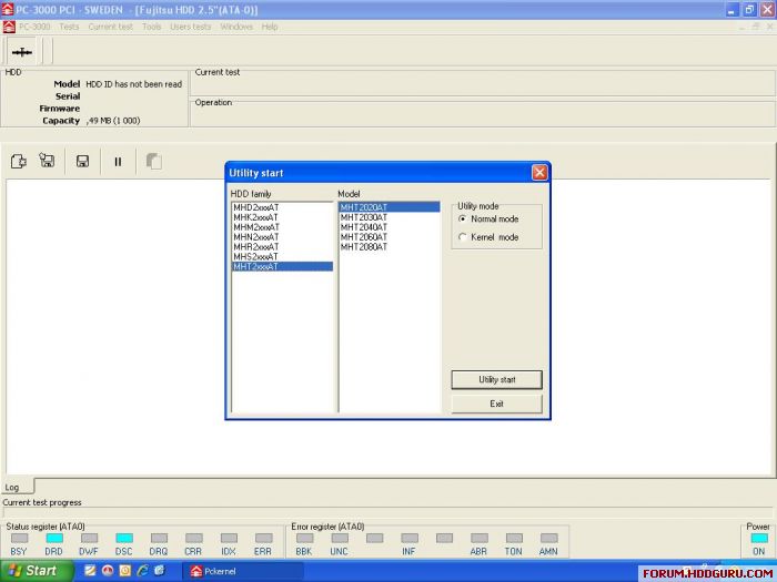

Hi coffeebean, the only thing I got in MHDD was "Device not ready".
It looks like this in Pc3000:
Or is it necessary with UDMA in this case?
Bosse

I open the drive in pc3000 with the wrong model name, with the intention to just check if it would read the drive....here is the log of it:
Selected family......................... : MHT2xxxAT
Selected model.......................... : MHT2020AT
Model by HDD ID......................... : <HDD ID NOT READ>
Cannot open file C:\Program\ACE Lab\PC-3000\Bin\!Profiles\FUJ25\FUJ_25.STG
Error loading utility options DB.
Loading default settings!
Open the options editing dialog to check and save them
Module table (ROM)...................... : Initializing with default parameters
WARNING! ID = 0104 : Name and RAWName do not match (HS <> Ô)
Loading : HS, head map module......................................... : Error
Error................................................................. : HS, head map module : Name and RAWName do not match (HS <>

It seems to read the modules okey.
Any suggestions how to get this drive to accept normal (pc3000) commands?
Bosse
