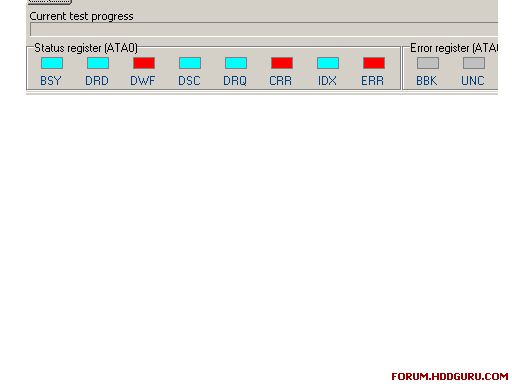

Hi all,
Got a MK4021GAS here, with the usual rattling spindle motor problem. Fixed that, now the drive spins up normal, calibration sounds normal, but not become ready.
Just get.....
Any suggestions? PCB? Hope not :-(

Try plug as secondary master with DOS and MHDD... :)
 Post subject:
PostPosted: July 4th, 2007, 9:57
Who's a clever boy.
MHDD picks it up OK.
Scans with errors
Now imaging in reverse mode in Media Tools.
Thanks a million coffeebean!
Just one question.... WHY does it work in DOS?
Cheers
Sean
 Post subject:
PostPosted: July 4th, 2007, 11:58
Posts: 4840
Toshibas work like CS jumper enabled, so U have to config things accordingly.
Cheers
Sean
Actually it will work just as fine in anything.
Just that fuxxin pc3000 dongle board requires some additional
jumper for Toshiba (as pointed out by pepe - CS) and in the acelab manual.

Hello Pcimage,
Chanced upon this post while browsing on a similar topic with Toshiba drives.
How did you fix the spindle motor problem? I got Toshiba MK6021GAS drive here, and the same rattling sound you described. Also the image you posted is also what I got from PC3k for STS reg, plus all Error Reg bits are red.
Any reply would be much appreciated.
