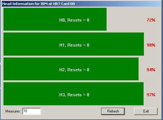

Please look at this picture...do you think that can be a weak head there?...indeed the head 0 is a little weaker than other heads but this is a 5 years old hdd and i think is normal....What do you think?

Hmm, they look fairly healthy.
You say 90% corrupted?
Where is the good 10%? Front, back, or all over?

I'm sorry if I'm interrupting, but what program were you using that shows the heads like that?
 Post subject: Re: IBM AVVA 80Gb problem
PostPosted: July 18th, 2007, 18:52
Looks like HRT to me ;-)

To rchadwick, Yes is HRT 2.1....
