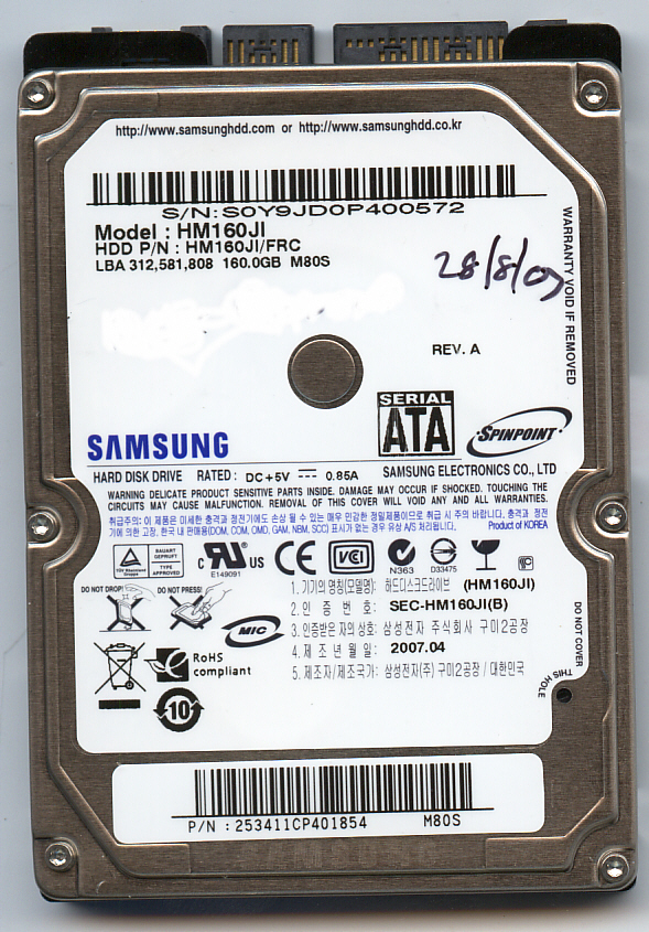

Hi all,
Got a 160Gb Samsung laptop drive with one bad head (consistant and regular patches of unreadable sectors)
Anybody head-swapped one of these before?
Is it enough to match model and country?
Or is there something else I need to check?
Not done one of these new Samsung laptop drive before.
The details from the label:
Model: HM160JI
P/N: HM160JI/FRC
LBA 312,581,808 160.0Gb M80S
SEC-HM160JI(B)
2007.4
Cheers
Sean

To replace samsung head you have to match P/V code
example if P/V MS then M is the media used in it and S is the Head used in it.
So to be sure you can match both the thing I prefer complete P/V code
P/V MS patient then MS for doner

Yep I know about P/V code on desktop drives, but I can't see one on this laptop drive.
160Gb: Almost brand new.
Thanks for your input

This is the drive:
As you can see, no P/V number :-(
Now, there's a "Rev. A" and a "SEC-HM160JI(B)

Try to match M80S bellow.

Yeah I was looking at that, but I figured that was the family code. You can do a Google search on "Samsung M80S" and it'll find loads!
But I'll give it a whirl anyway. Usually laptop drives aren't quite so fussy anyway.
