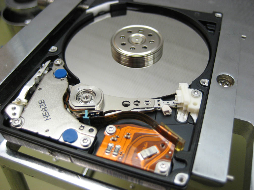

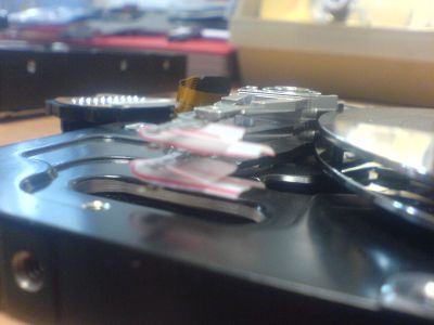

Hi All,
I have had some trouble with head swaps, i have heard people use folder paper, melted drinking staws and some other tools to keep the heads from touching when removing the head stack from the disk to put into another disk.
Can anybody supply a photo of the setup they use or how they stop the heads touching? I saw one photo of a guy using post-it notes on this forum but it was not a good example.
Does anybody have a photo (not a diagram) of how the heads are seperated so they do not touch? I have used paper and small pieces of cardboard but they end up falling out when the heads are moved ot bumped..they heads always touch and it's so frustrating. Any helpful information would be greatly apreciated.

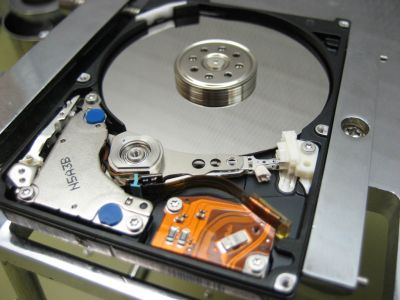

Hi, here is a closeup for you....hope it helps.

Thanks, that's exactly what i was after.

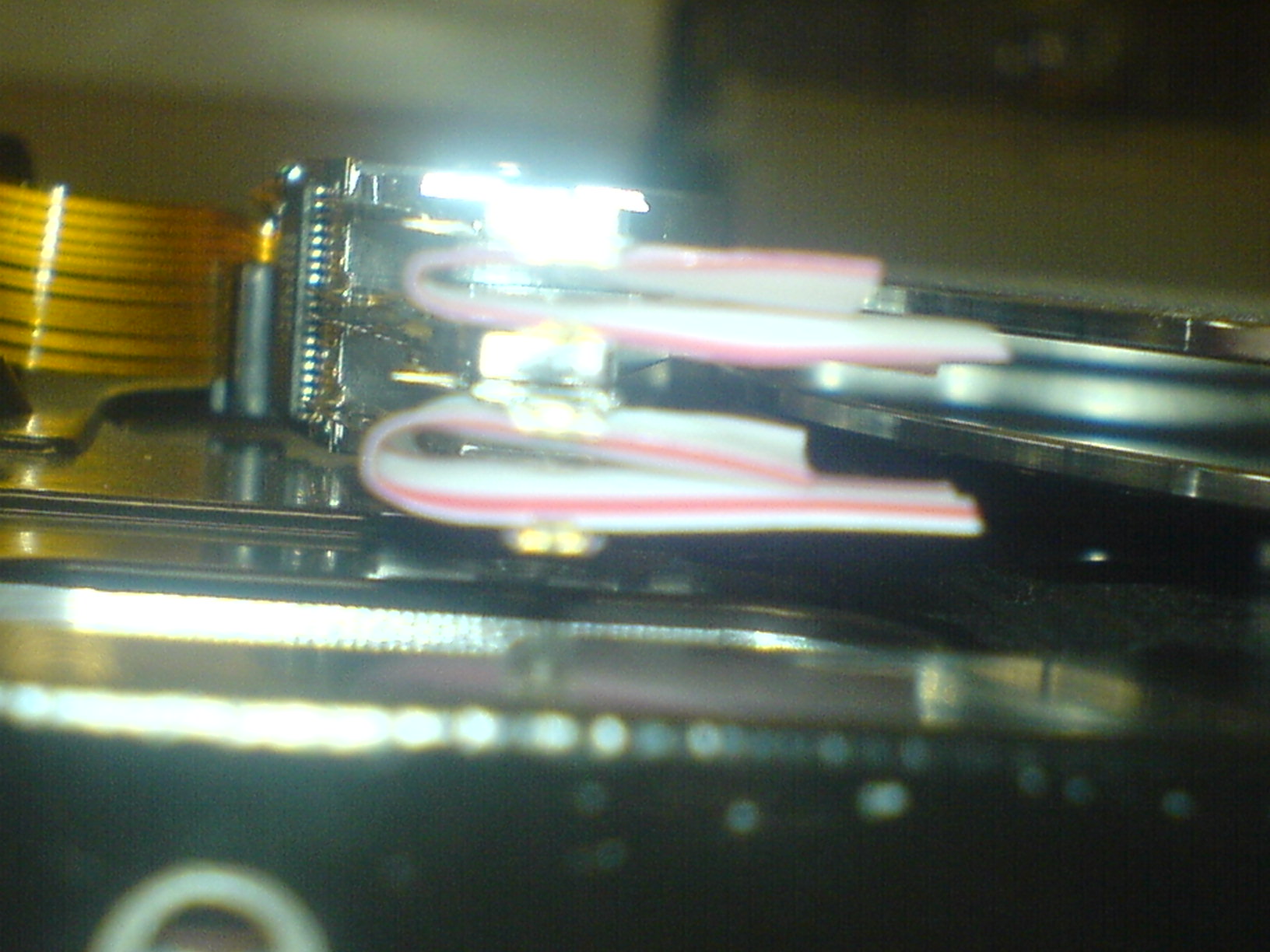

Use strips of plastic like you get from kid's toy packaging cut into long strips about 3" by 1/4". Fold in half without creasing so they spring , spin the platters and move the heads out towards the edge, slip the plastic under the arms near the heads so the plastic holds them apart, and off the disks, & remove the head stack.

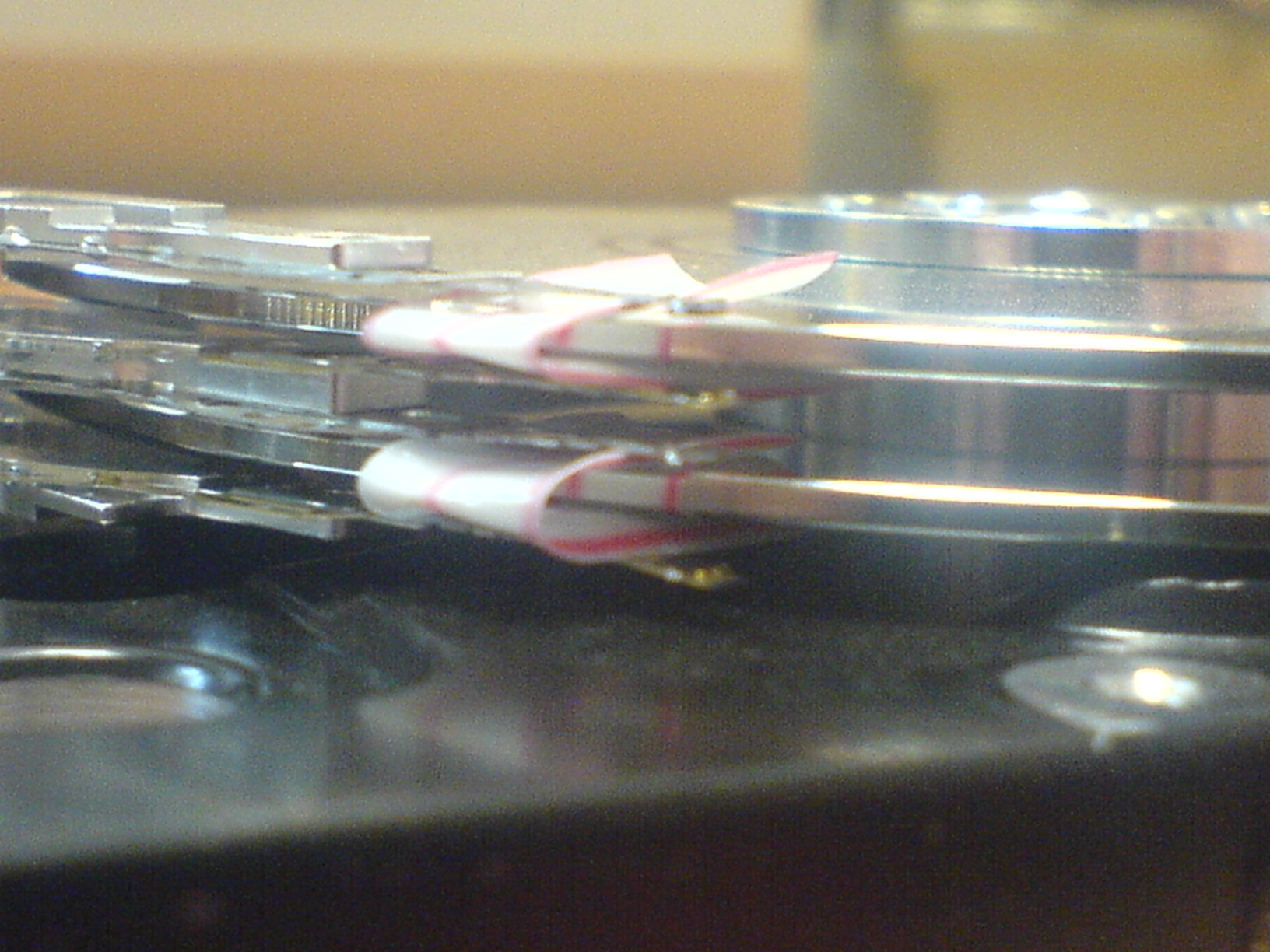

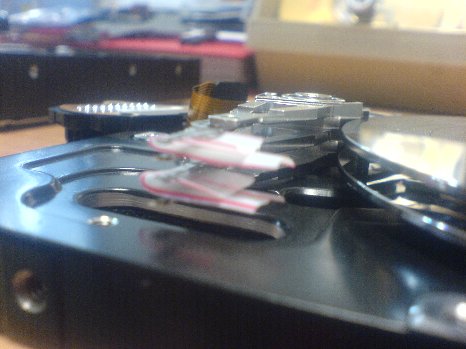

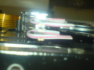

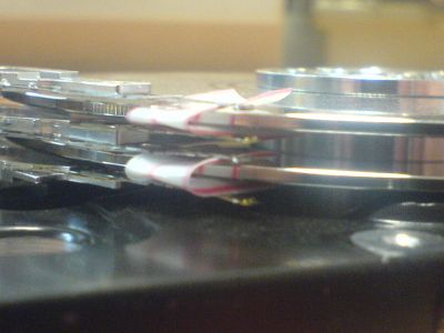

I use drinking straws.
Sorry about the photos quality...
