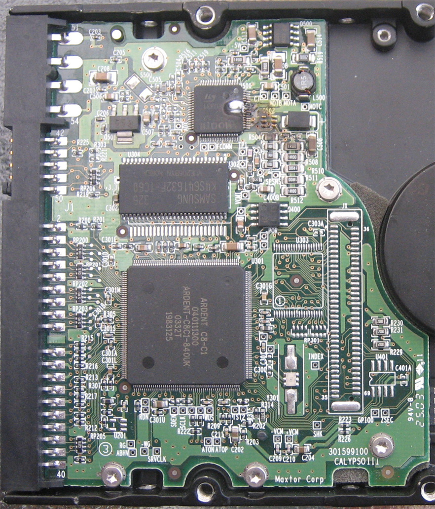

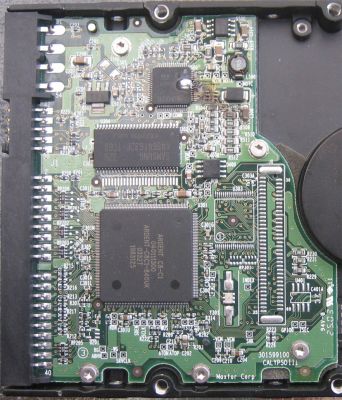

Joined: September 3rd, 2007, 19:03
Posts: 14
Please see the attached image. This is all the information I have. There is no label on the PCB. The other side of the drive identifies it as a Platinum 160GB 7200RPM HDD.
Where can I locate the specific PCB to replace? Oh yeah, also how do I remove the fried PCB????
Appreciate any help...
JT

Hello~ You can find much info on both sides of HDD, like below:
Maxtor DiamondMax Plus 9 160GB ATA/133 HDD
YAR41BW0
6Y160P0042811
PCB:
M8FYB
301862101
ARDENT-C8C1-840UK
SMOOTH-L7250E 1.2
For removing the PCB, just using a "6-star" screw stripper to remove the 5-screw.
Then you can separate the PCB out.

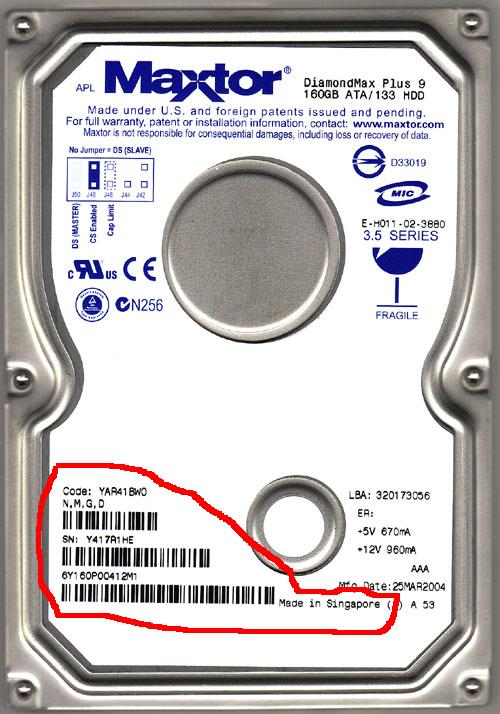

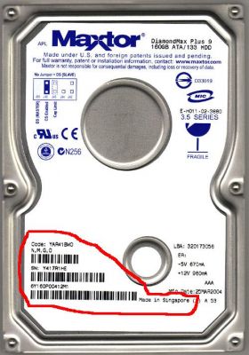

Hi OZETEK
Look at the frontside of the harddrive....should look simular to this:
[img]
[/img]
Write down those numbers and letters and put them on this forum.
Bosse

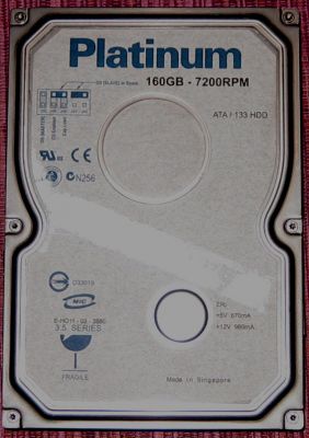

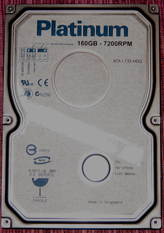

Posts: 14
Hi all, many thanks for your ongoing support. Here is an image of the top of the HDD. As you can see none of the info as shown on the Maxtor drive. Where to now?
File comment: Top of the Paltinum 160GB HDD Case.
