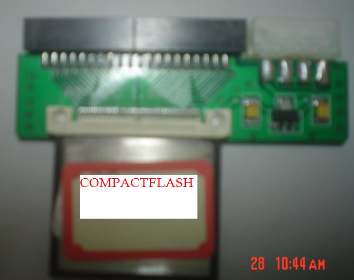

Hi to all.
I have an adapter of hdd 1.8"for IDE and perceived that they are equal to the connector of the CF, I can have access the CF with this adapter?
Or to have access hd 1.8"Of the READER OF CARD CF?
The bolts have the same function of the CF with HD 1,8"?

Look for doc CF
http://www.compactflash.org/cfspc4_1.pdf

Hi Guys i just finished the same.
I had to check a ipod hdd 1.8" .I haver the same converter the left side is pin 44 and the right side is pin 1 .If the 1.8" drive holes point towards you make sure the totally round hole is in the right side and the hole which is elongated is on the left .Then just yank then together .Its Done
