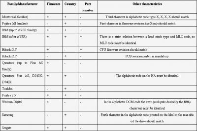

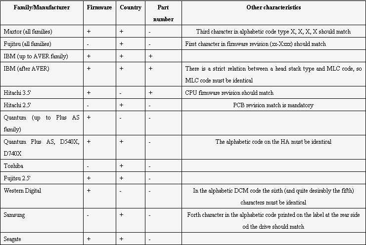

Hi All,
I have been looking for some good information on how to find a replacement PCB for different brands and models.
Can anybody with experience contribute the rule to find a compatible PCB for different brands (e.g WD, Maxtor, IBM, Hitachi and Samsung especially). If you know what's needed can you please share?
I have found the followinig resources and thought it may be helpful to other forum members:

Hi Zed ,
I am also new and learning bit by bit. From my personal experience for seagate drives in order to have matching donor pcbs f/w is major criteria. Both pcbs must have same firmware. (some times you need to check rev. which can be found on back side of the pcb.)
e.g -100139362 Rev B. I have got fair success if problem is with logic card.
To really get a match for seagate you must check Nos. of Microcontroller / Spindle controller and layout of power components.
