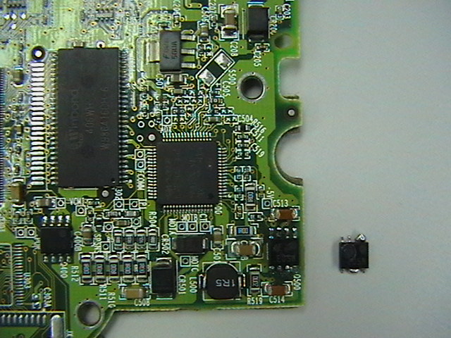

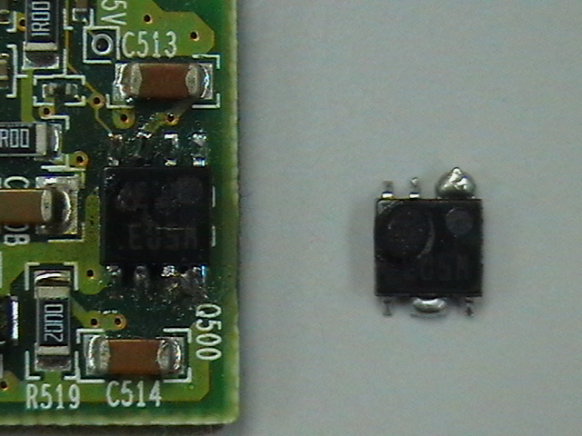

Yesterday, My DiamondMax Plus 9 160GB ATA/133 HDD 's W503 IC suddenly burnt out! So i replace a good W503 IC again from another HD (DiamondMax Plus 9 80GB), The result is the same. The W503 IC burnt out too....>.<
So is it possible to use another DiamondMax Plus 9 HDD PCB to re-drive the 160GB again??

From the first description it is not neccessarily a preamp failure, though it can be.
It is possible that Q500 doesn't get proper driving signal from U500 at pin4.
In this case U can replace the PCB with a compatible one, and it will work, but if the preamp is gone, don't try a good PCB, it will be toasted too.

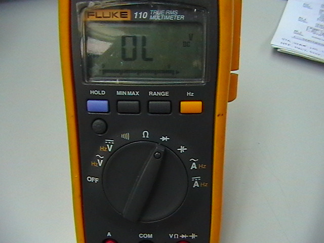

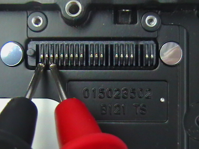

U can check the preamp with a multimeter, put it into diode checking mode.
Attach the red (positive) terminal to the GND pin and the black (negative) one to the -5V pin.
If the multimeter shows any value other than infinity, the preamp is gone. If it shows bellow ~1.000 the new board will be damaged probably if U try it.

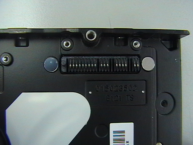

Dear pepe,
I follow your instructon to check with some photos for reference.
First, do i do the test correctly??
And i find it's infinity, does it mean it is a good news, and i can try to replace a good PCB?
P.S. I'm waiting the IRF7326D2 IC delivery to replace the burnt W503 IC.

sorry, the illustration appears to be somehow different than I sent.
it should look like this:
I  I    I  I  I  I    I  I  I   I  I  I  I  I  I  I  I  I
                                            -5V  GND

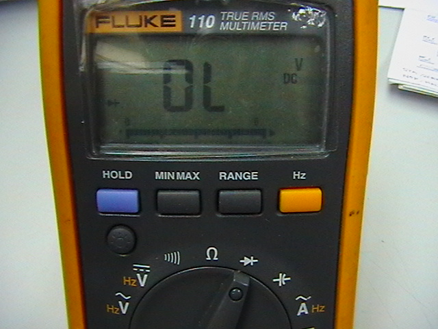

Hi pepe,
I got "infinity" result again. is the preamp still fine?
But i test a 80GB HDD, it takes 1.340 result.
Please kindly advise.

The IRF7326D2 IC is just received, and will have a test again after soldering.
Hopefully, it works!!!

Before i test with a new and good PCB, Anyone can answer me this question?
Here is the history:
I stupidly connect the harddisk 4-pin power cable in reverse direction.
In other words, 5V->12V and 12V->5V.
Initially nothing happened. When i noticed i mis-connected the power cable, i re-plug the power cable again (within 1 min).
Then i turn on the PC again, the W503 IC burnt!
So i would like to ask whether the wrong power cable connection can cause the pre-amp dead?
Thank you very much!!
 Post subject: Re: Maxtor 160GB harddisk burnt!
PostPosted: September 27th, 2007, 11:15
Posts: 4854
It can and it did :(
