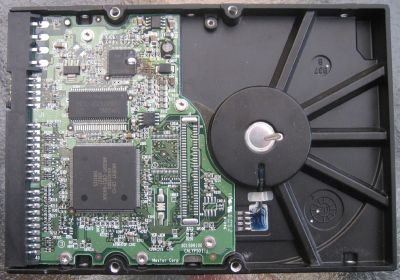

Can anyone advise where to find a replacement PCB? It is for a Platinum 160GB ATA HDD. Thanks.

There would be a sticker on the pcb that has a five letter code on it please post here that way it will be easier to find pcb .

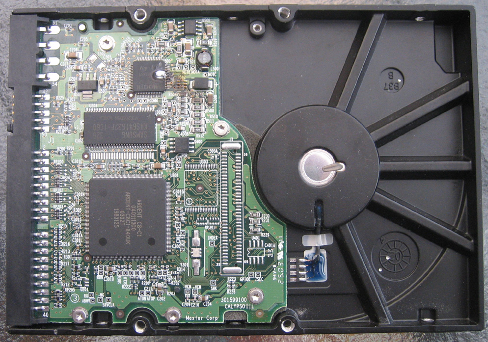

Hi all, many thanks for your advice so far. Here is a copy of my HDD. I need to know if I replace the PCB whether this will allow me to recover the files? Also how do I remove the PCB and where can I get a replacement PCB. If you have one please PM me so I can get this happening.

File comment: Platinum 160GB HDD with "fried" PCB

Hi
Your PCB does not havde an external ROM, so any Calypso III board with the same Ardent chip should work fine.
But if the HDA blows the new PCB, then u have a preamp problem.
Good Luck

Thanks for the advice. Where can I find a replacement Calypso III PCB and how much are they? any ideas?

No problems. Received one from Malaysia in a week from Softcom. Thanks all.
