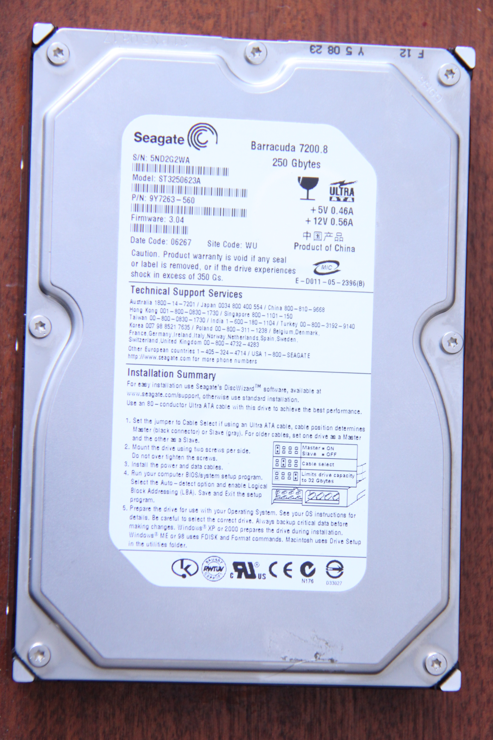

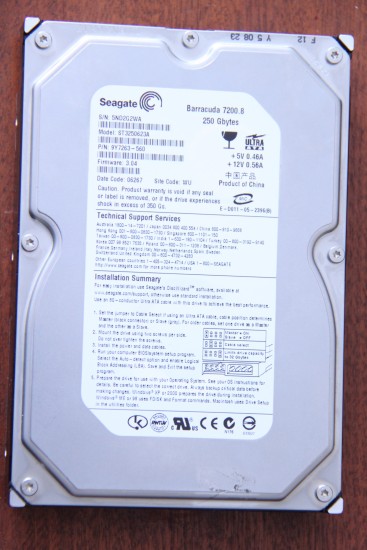

Do you still have the harddisk?
I have a desperate need for the PCB...
My specifications are:
Barracuda 7200.8
Model:ST3250623A
P/N:9Y7263-560
Firmware: 3.04
Date code:06267
Site code:WU

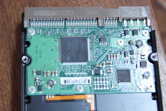

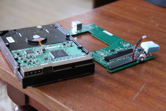

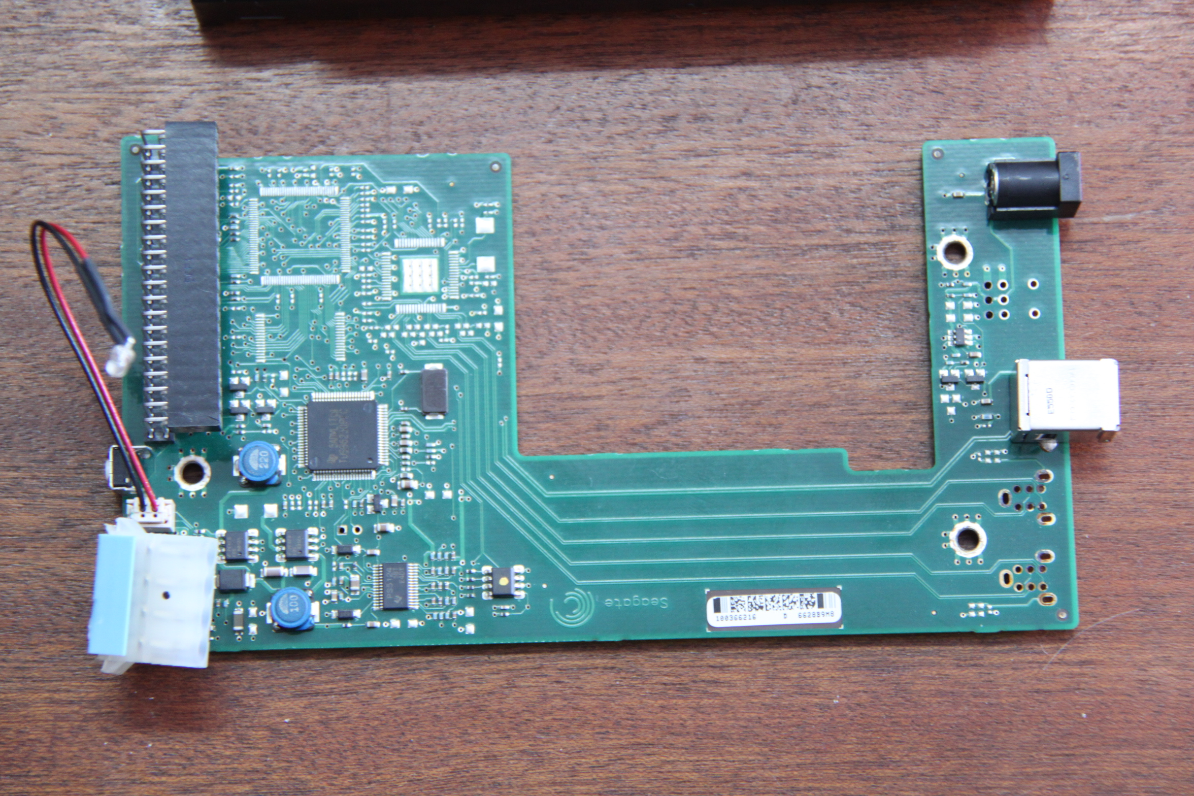

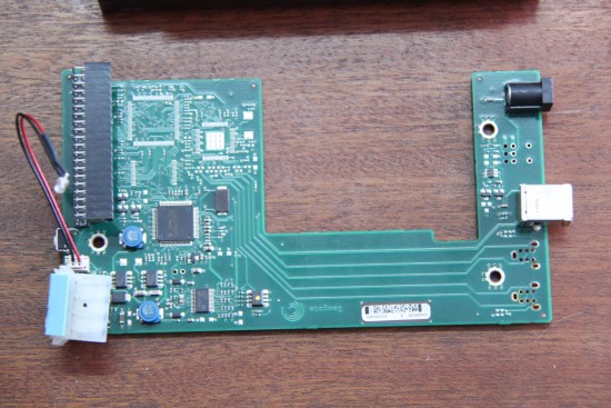

 Post subject: Re: MHDD SCAN ok but ERASE show broken disk
PostPosted: February 8th, 2010, 15:57
Joined: February 2nd, 2010, 18:42
Location: Romania

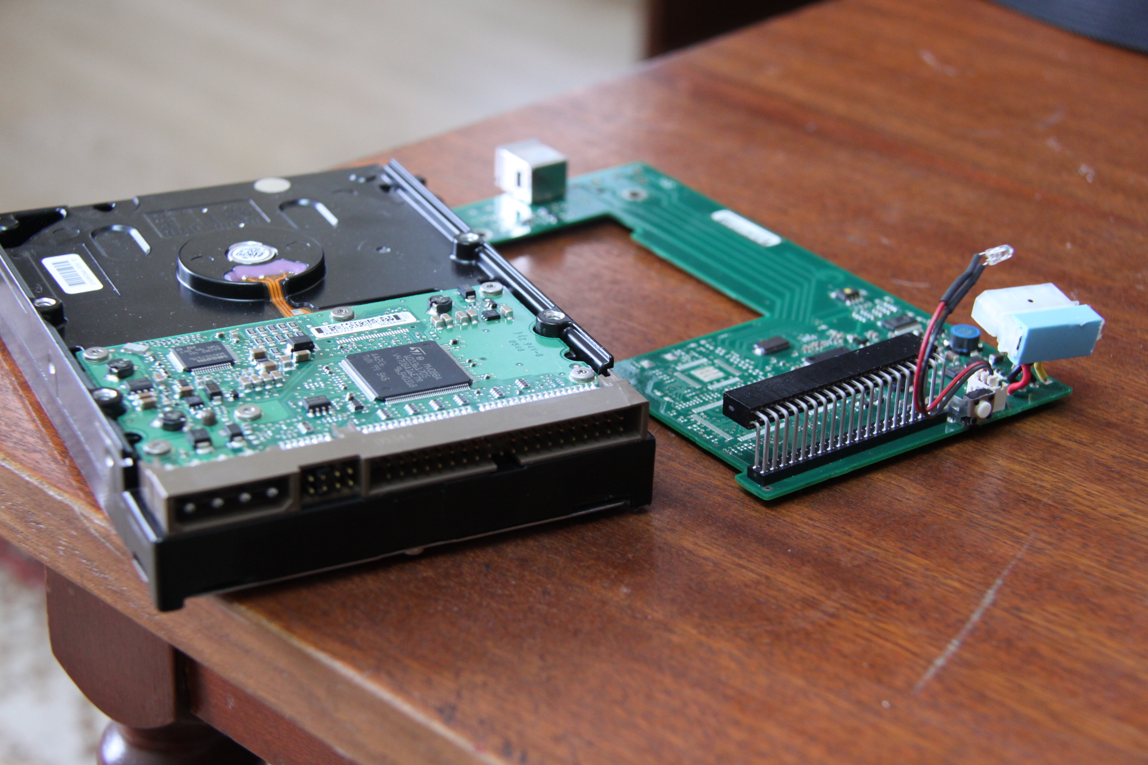

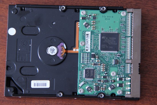

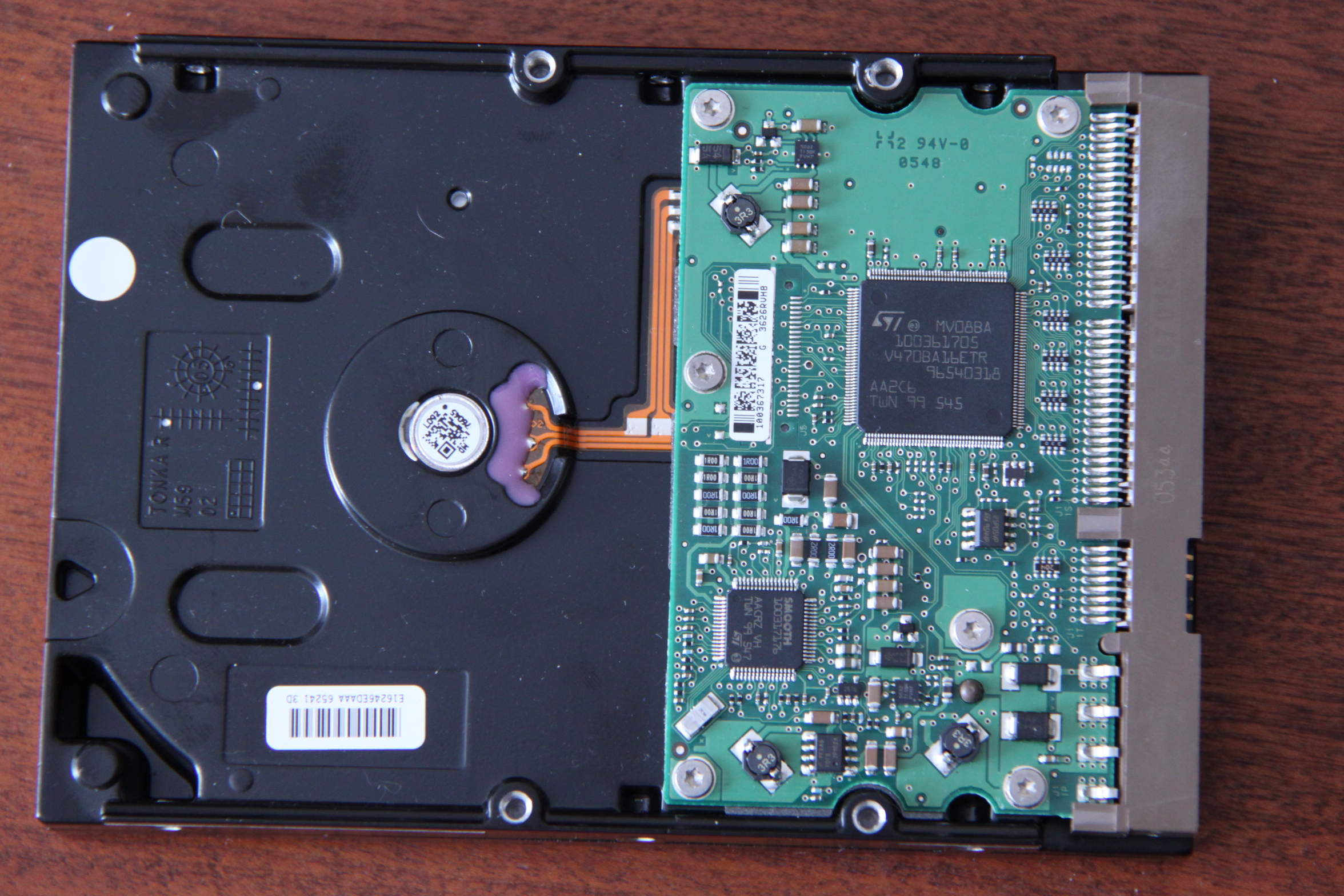

Symptoms: After a long time not using the drive, I needed some files and I connected to the computer. The HDD did nothing. No lights, no noise, no spinup... absolutely nothing. Dead. No smell of burned circuitry.
Opened the case (it was a USB external HDD) and removed one of the boards, with power and USB connections.... and aI was left with a normal internal HDD.
Tried to connect to a desktop computer using power connection and IDE cable.
The computer didn't start, but instead started to beep continuously.
I deducted that there is a short somewhere on the PCB.

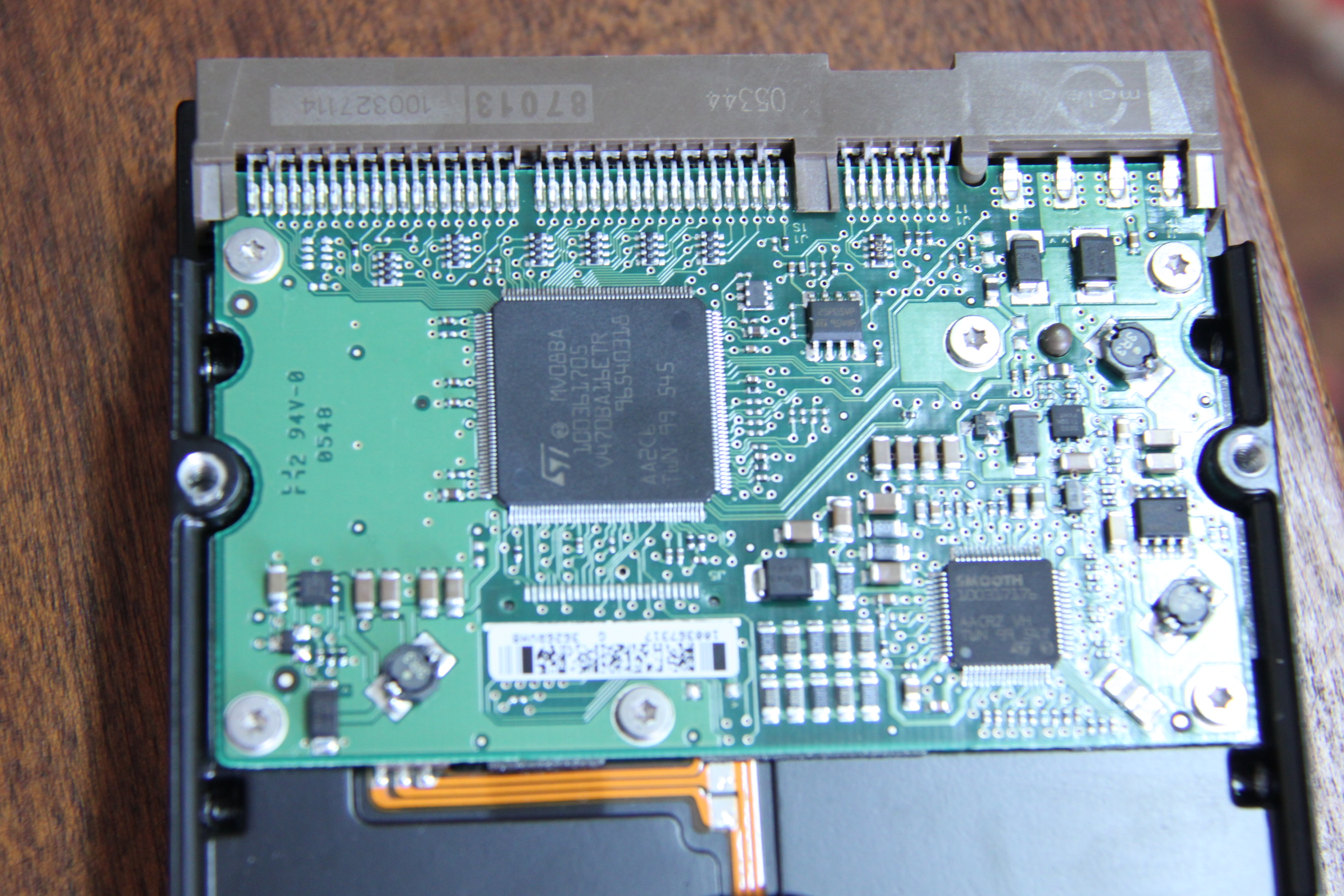

Later, I succesfuly managed to break a small 8 pin component on the upper left corner. (miiisa very clumsy sometimes. miiisa banging my head to the wall to no avail)
Never before the HDD had any logical problems.
Does anyone of you have a PCB like that? Or a PCB that will mach?
The specificatins seems to be the same with the owner of the thread. (see my other message).
I am hoping I can borrow a working PCB just enough to transfer my files, and then return the PCB to you (obviously I cannot trust this HDD anymore and I will never use it again).
If the party wants it, I can give the rest of the HDD for parts (hope you'll never need parts, but... better safe than sorry).
Or I can simply buy the PCB, if you don't need it anymore and want the money.
Or any other solution you may think of.
All I need are my files. :)
You can contact me at jazzcat_ro[at]yahoo[dot]com
First person who give me a solution gains a sixpack of beer, at his choice :)
Along with my eternal gratitude.
Thank you guys...
File comment: Boards, side by side. Don't they look sweet? :)
File comment: The USB circuitry and power adapter circuits (my guess).
File comment: Detailed view of the PCB. Missing circuit - upper left.
File comment: PCB. you can see the codes on the main chip. Also you can see the empty space where the broken circuit used to be. Near the corner screw.
File comment: General view of the HDD (with additional info, if you need it)
PostPosted: February 8th, 2010, 16:48
Posts: 17320
Your drive probably has a shorted TVS (transient voltage suppression) diode. You can desolder it or snip it out with sidecutters. The drive will work quite happily without it, albeit without protection on the corresponding supply rail. Just be sure your power supply is OK.
See the photo of the PCB in this article:
http://hddscan.com/doc/HDD_from_inside.html
For continued protection, you can replace your diode with an SMBJ12A (12V) or SMAJ5.0A (5V). These are available from Farnell, Mouser, Digikey.
Your TVS diodes are located near the power connector.
Here is the datasheet for the 12V diode.
600 Watt Peak Power Zener Transient Voltage Suppressor, 12V, Unidirectional, p/n SMBJ12AON (marking = LEM):
http://www.icbase.com/English/ic_search ... 380605.pdf
The missing 8-pin component appears to be an array of four 82 ohm resistors. You can replace it with 4 discrete leaded resistors by soldering them at the plated through holes on either side of the array. You may need 1/8W resistors or smaller. Or perhaps you could use a package from a scrapped hard drive.
PostPosted: February 8th, 2010, 19:22
Posts: 1721
The board on the right do not worry about this one at all it belongs to the enclosure of your USB.
One you have tried to hook this drive directly to your laptop via IDE cable and power connector and the system beeps at you. This could be a short in the PCB that is causing this problem. Get a Voltage meter and set it to 200 and test the two TVS on the upper right hand corner of your PCB board and if one is shorted out you can remove it.
Then try again to attach this to your computer direct and see what happens then,
Look closely at the large smooth chip on your board and make sure it is not burned or you an see a small pin hole in this chip where it could of been burned from. Last but possible it could be the motor IC chip that is giving you problem. Start with the simple TVS and work from there to see if this one works for you.
