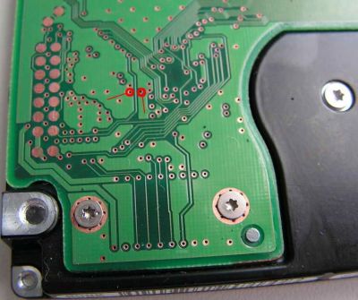

Hi Guys,
Do you have any idea how can I remove an ATA password from
a HITACHI HTS424040M9AT00. I have PC3K, ISA and PCI versions but either
supports this model for password removal.
I appreciate Any hint or advise.

 Post subject: Re: HITACHI HTS424 series password removal
PostPosted: November 8th, 2007, 10:47
HTS 424 is supported in 2.27, but not for password unlocking. AFAIK
At least I don't know of probe points, if any exist.
PostPosted: November 9th, 2007, 13:21
Joined: November 1st, 2005, 10:04
Posts: 238
ace did give points for HTS424, but their probe don't work
because their probe works on about 10-12 ohm.
you need more resistance, but not as much as 20 ohm. :wink:

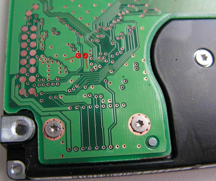

PostPosted: November 12th, 2007, 13:32
Posts: 637
Location: Canada
Here's a picture I got from Acelab for HTS424.
But it didn't work in my case, so I went with NVRAM method.
File comment: hts424 probe
PostPosted: November 13th, 2007, 1:03
Joined: April 16th, 2005, 11:34
Posts: 92
Hi Starling,
Thank you for the PCB image.
As you have mentioned NV-RAM method works great.
I could unlock the drive easily following the instructions which
I received from you and PCimage :)
Pninja
