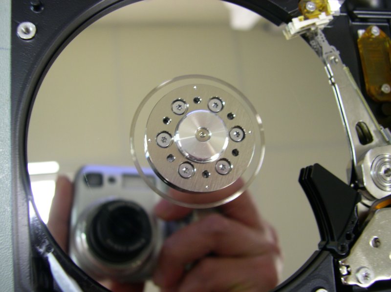

I have a Lacie Big Disk 500G (two 250GB drives RAID 0) which has been accidently dropped, one of the disk is ok and the other has a scratched platter as shown. The inner edge and also a little hair line scratch in the middle.
Any chance of getting the data? the SA is located in middle as pointed out few gurus on hard-disk-drives-repair-and-data-recovery-f1/please-it-looks-at-the-photo-t8130.html
I could not observed the bottom platter as it comes with 2 platters and 4 heads, so the condition of the remaining platters are unknown.
Take a look the photo, the drive is Hitachi Deskstar HDT725025VLAT80.
Thank's guys

I think it is impossible to get data from this drive

Hello terranova the head crash looks on the land zone, maybe u can tried some thing.s but its not a easy case check u PM to check the bottom platter u can use some useful tool´s from doctor´s

thanks beto, 4 platters were all damged, even the filter bag tuned into black :D
