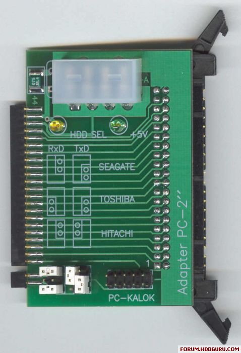

I have a WD400VE and need to put it in safe mode. Can anyone tell me(or show me) the details of the pins that need to be jumped of the four pins on the PCB?

Hi
Remove HDA from pcb and connect only PCB to power and data cable. and BINGO :)

Hi, I thought it was as Mikippp showed:
WD Scorpio PSV Mode...
[img][/img]

Not if you don't have that adapter :(

Okey, I assumed that you had Pc3000!
