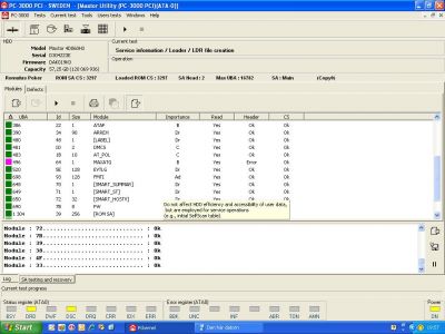

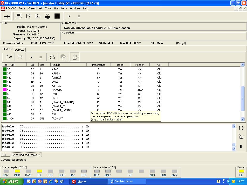

Hello friends,
I need module 64 from this drive (see pic), errors on both copy1 and copy2.
Maxtor D540X
Model: 4D060H3
FW: DAK019K0
Bosse

Or the whole FW would be okey.
Maxtor D540X
Model: 4D060H3
FW: DAK019K0
Poker Chipset
Rgs/ Bosse

As far as I see, it is normal that this module has only zeroes in the header, and U can write it from any other drive in case it is damaged badly.
