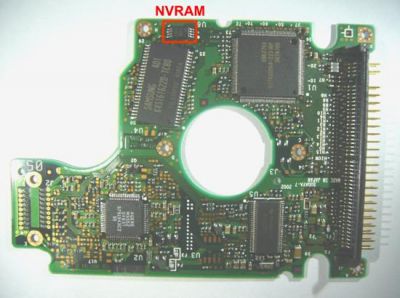

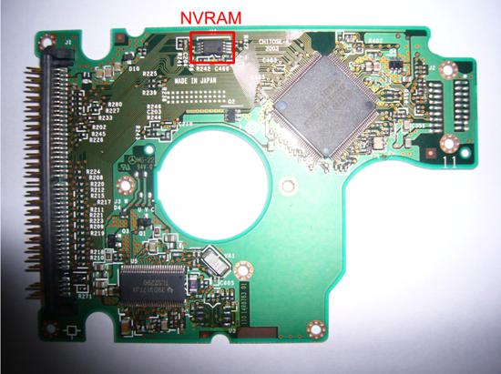

NVRAM Chip used in IBM/Hitachi HDD and the countermeasure for doing a data recovery
First let’s take a look at the NVRAM (Non-Volatile Random Access Memory) used on HITACHI HDD, NVRAM is one member of NVM※(see introduction at the end)family, it can process data accessing randomly and keep data even when power is off, but its price is comparatively more expensive than the former ROM.
NVRAM of HITACHI HDD saves important data such as number of HEADs; beginning position of SA, ROM overlay module checkout and platter adaptive parameter.
At present, HITACHI is the first manufacturer to use NVRAM as the media for saving key information.

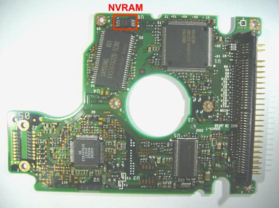

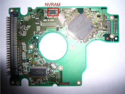

The following are two typical HITACHI PCBA Layouts; the mark shows the NVRAM position.
In the former HDD products, the important information such as number of HEAD, media adaptive and so on were saved in the ROM chip or the SA on platter. HITACHI first uses NVRAM as the storage media for its key parameters and adopts one very important feature: Random Beginning Position of SA. Each HDD takes a random address as its SA (Serve Area) beginning position (basically we can say in this new tech every HDD has a unique firmware beginning position address). This unique “Random Beginning Position of SA” for each HDD is to be saved in the NVRAM of itself, which means each HDD can work with its original NVRAM only, just like one key opens one lock only; Once the data in the NVRAM is broken or being lost, there will be no operating system or software tool which can detect the HDD, not to speak of working on the SA of the HDD. Therefore, The HDD repair or data recovery becomes mission impossible, even the former universal ways like “HOT SWAP PCB” become useless in such case (the information stored in each NVRAM is unique), we can do nothing about it, the HDD is dead, also your invaluable data. This remains until the “HD Doctor for IBM/Hitachi” of SalvationDATA becomes available.

File comment: NVRAM1.jpg
