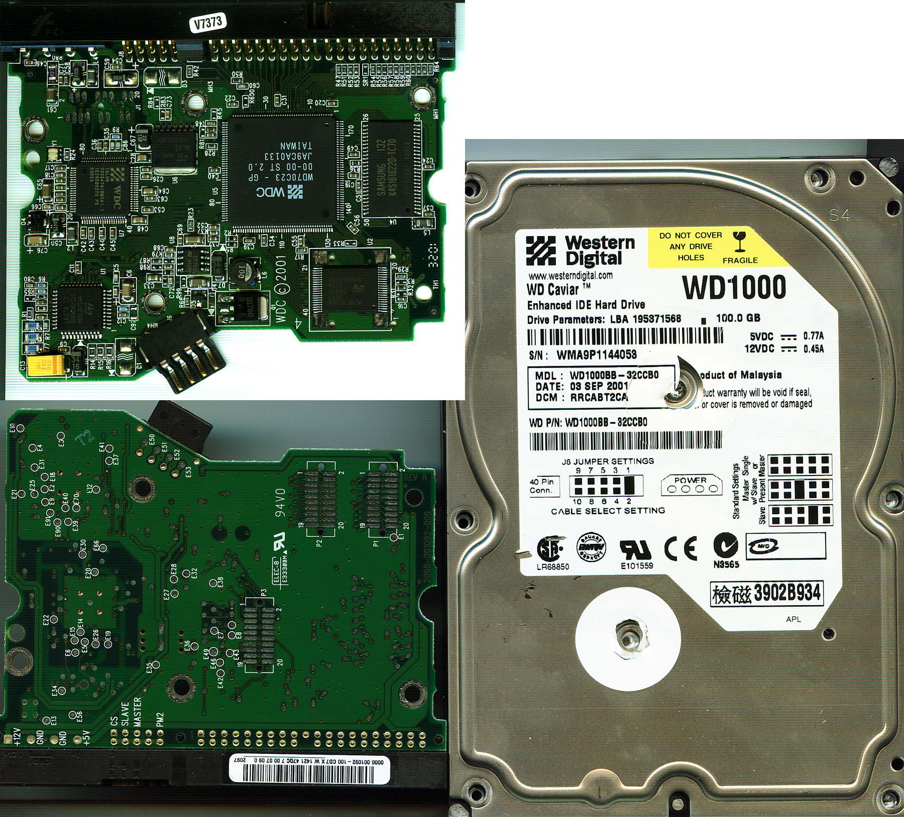

Can anyone point me to a logic board with will work with this drive?
Western Digital WD1000BB-32CCB0, Logic Board Barcode=0000001092-100CD7

 Post subject: Re: Western Digital WD1000BB-32CCB0 - Need Logic Board
PostPosted: January 7th, 2008, 21:47
Joined: January 1st, 2008, 10:42
Posts: 6
Pardon my ignorance, but I'm not exactly sure what you are referring to. Does the attached image help (the top of the HDD, top of the circuit board, & bottom of circuit board)?
File comment: Scan of drive & board
PostPosted: January 8th, 2008, 5:58
It's the U2 chip in the bottom right hand corner.
PostPosted: January 8th, 2008, 10:52
Joined: May 21st, 2007, 16:10
Posts: 1592
Location: Gothenburg/ Sweden
Your board number is: 2060-001092-006....as seen on the backside of the Pcb.
Match that and swap ROM-chip, or reprogram it and then it's done.

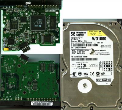

Has anyone such a PCB for me ?
thx
PostPosted: February 5th, 2008, 7:21
Joined: February 5th, 2008, 5:35
addendum
to clarify my request

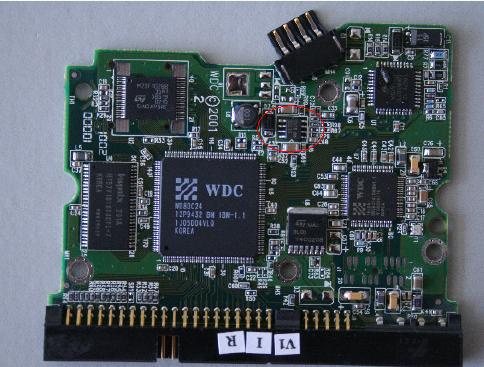

PostPosted: February 5th, 2008, 17:46
Posts: 1592
You can use almost any board from the BB-series....80Gb, 100Gb, 120Gb, as long as the backside of the pcb looks like your's.
After you bought the board you have to swap (change) the ROM-Chip (inside the red ring..see picture), after that you're good to go.
Bosse
[img]
[/img]
http://www.rescue-it.se
PostPosted: February 6th, 2008, 5:58
Your PCB has the ROM chip in a different place to the above (this is a "Silver I" type PCB)
It's the larger chip, top left, position U2.
Somewhat more difficult to physically transfer.
However, being an older WD drive, just get a PCB of same P/N (e.g. 2060-001092-006) and same model HDD (E.g. WD1000BB-xxCCB0) and u should be OK.
Sean
