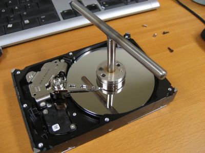

I'm currently working with a Seagate Barracuda 7200.10 (Tonka) drive with motor spindle bearing resistance.
I would like to remove the bearing cap and lubricate the motor, but on this model bearing cap that is recessed inside of the casting. It is like looking down inside of a small crater.
Has anyone drilled out this type of cap? If so, how? Or alternately, had success swapping platters and motors with the Salvation platter tool (on a Seagate Barracuda drive with two platters)?
I've got a dental appointment tomorrow and I'll see if he has any bright ideas. I'm desperate!
Thanks in advance.
Jon

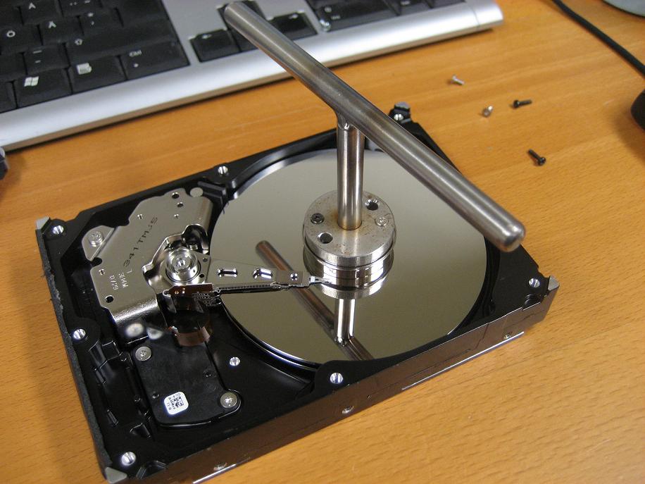

Hi Jon, thanks for the Pcb Btw you have back soon :-)
I've great success with my home made tool for free stucked motors and bent axxis.
The last one I had success with was an 500Gb Seagate with plastic airlock.
Have nice time with the dentist tomorrow 8)
Regards/ Bosse

mr_spokk,
Can you tell me the price of that tool for free stucked motors and bent axxis?
if you cant sell, pls tell me how to make one (you said it was Homemade).
Thanks,
RDS.

I had a tool custom made that was similar to the one that was shown, except that it used a standard "T" and was drilled for Maxtor, Seagate, & WDC.
I used it to free up the Seagate I had posted.
However, the bad bearing vibrated enough to keep the heads from reading . . . :(
I wonder how people deal with the collar that is between the platters? I can't figure out a way to do a head swap. I can't think of any good reason why Seagate might have added this part except to prevent platter swaps!
Jon
http://www.datasaversllc.com

I have tried the drilling method, i have got inside and put oil in there but the 'burr' is jammed so tight it does not move with oil added. In cases where i have had jammed motors, i cannot even move the motor manually with full force using plyers or other tools! It's just stuck solid!
Does your 't-bar' tool you created actually get the motor loose/free again?
I've had to do platter swaps out of desperation...no other quick fix found.
Zed

I tried it on only one drive and it worked.
How do you do a platter swap on a Seagate with the plastic ring?
Jon
