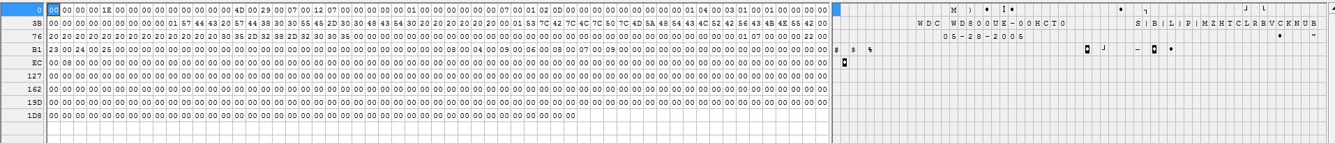

questo scusate per prima che non si vedeva....
grazie grzie

ho provato la user wdcwdcwdcwdcwdcwdcw niente da fare
mi aiutate comunque leggendo i post precedenti , vorrei trovare la password e non mi interessano i dati che sono caricati
la passw è stata impostata forse da mio nipote ad un EEpc 1001 PX ASUS
If that is what you used then it is wrong!
The master password would at least be WDCWDCWDCWDCWDCWDCWDCWDCWDCWDCW as written.
And I would say the user password also looks rather strange.
You might have to retrace your steps and check your method. Something dosn't look right!
AIUI, the user password precedes the master password, in which case it is filled with zeros. However, the leading bytes are 01 01 rather than 01 07, as in other hex dumps.

as duties proceed from the two files in the figure 22.bin master password and user what would be??
I used MHDD and found the 22.bin then tried to use the software victoria 4:46 but I get error "Passport drives get error" why??

For Victoria for Windows you might have to set the bios into ide/compatibility or legacy mode.
You might also find the computer bios freezes the password function on boot. So you would have to plug in the power connection to the hard drive after the system has booted. With great care of course!

schoen02 wrote:
I have a locked WD800UE , but the bin file looks different from the other ones in this thread.
That's module 1Eh. You need module 02h.
Which script did you use?
BTW, you can see the structure of each module here:
http://www.datadonor.net/HD%20Western%2 ... 22HCT0.zip

sanlima wrote:
you are not the only one who can unlock a hard drive wd ...
I repeat that I have just unlucky
Meeting a master password and user are not a thief or other .....
help me :roll: :roll: :roll: :roll:
Your drive does not appear to have a user password, only a default master password.
