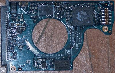

Anyone has an idea where the parameters for this drive are stored ?
The Marvell chip is cooked, so i hope it is not in that one.
Any help appreciated.
Thanks in advance,
Dobre
File comment: PCB

Hi Dobre,
Let's think a bit...
IC6 seems to be Motor Combo,
IC21 must be Buffer RAM,
IC26 seems to be a DC-DC converter,
As I don't see any other IC, I am afraid the ROM code is in the Marvel..... :(
However I am almost sure there's a copy on the surface, but I haven't have time to research this matter and how to load this code into a new PCB....
so I don't have a solution for this thing at the moment.

That's correct pepe
ROM is inside Marvell chip

how do You know it is dead?
 Post subject: Re: MK8007GAH 1.8" Toshiba Parameter storage
PostPosted: February 5th, 2008, 4:22
Posts: 1852
Location: Belgium
Hi Helpdisk,
As soon as i put power on it the pcb draws some amps and the Marvell Chip gets really really hot.
Dobre

open the top cover, On those drives I had only motor stuck problems.
