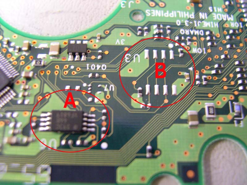

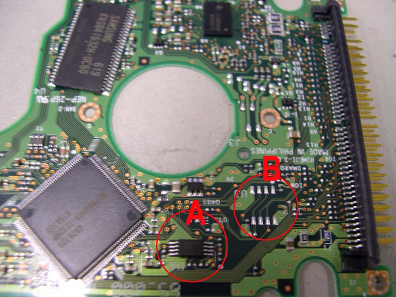

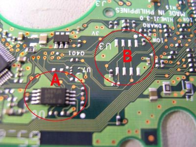

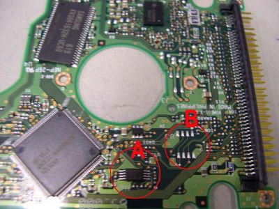

I have a Hitachi Travelstar HTS541060G9AT00 with PCB faulty, is there any ROM on the pcb? some PCB has and some doesnt, any idea guys? Is the ROM located in "A" ? My pcb has empty "B".
Thank's in advance.

A is NV ram. and that is what u needed.

ROM is inside CPU on this drive

the "A" is the NVRAM.

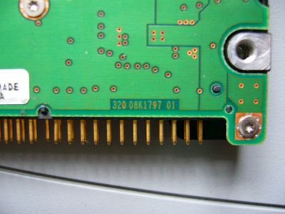

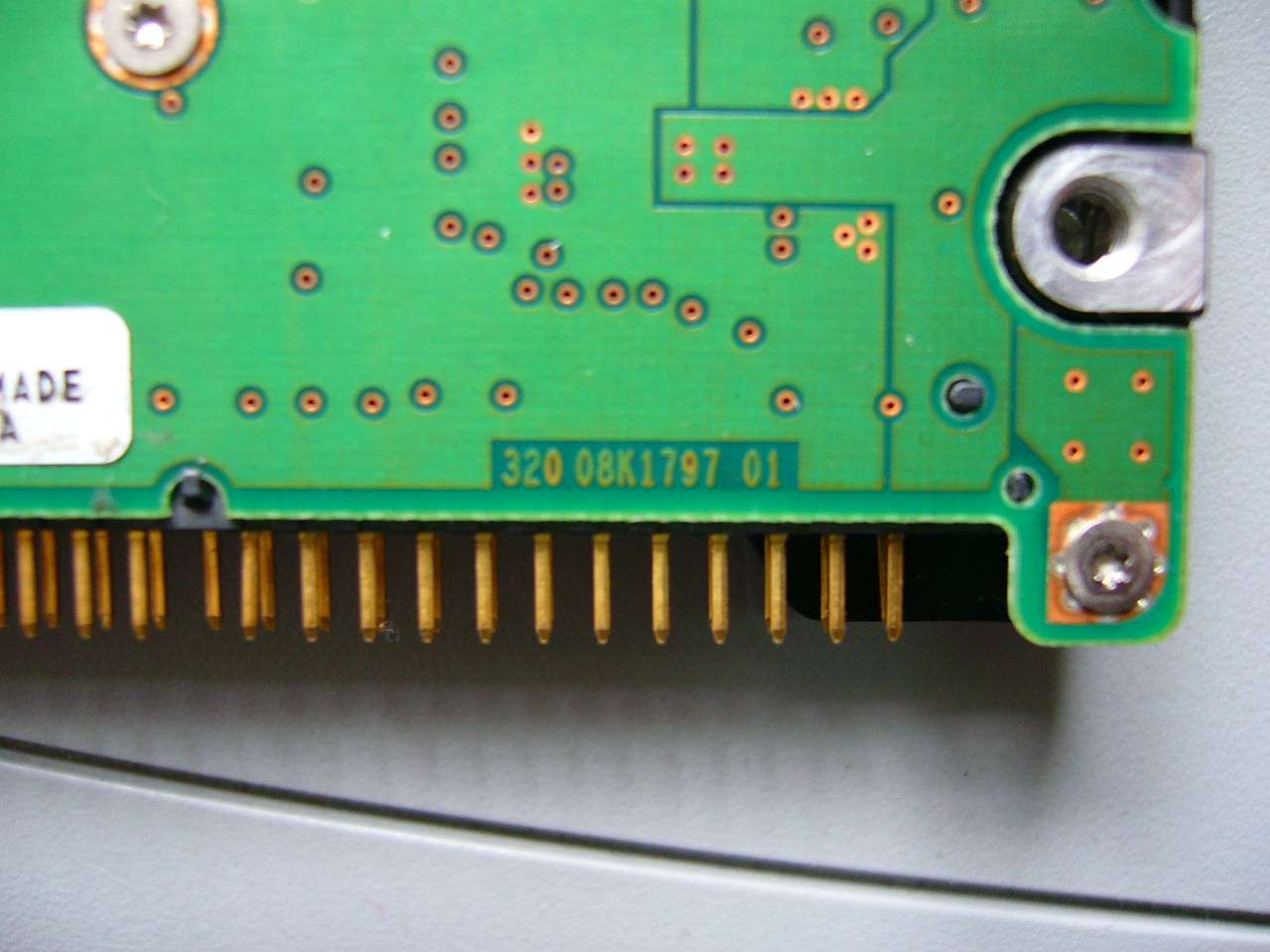

Hi SL, 320 0A21010 01
 Post subject: Re: Hitachi Travelstar HTS541060G9AT00 PCB faulty
PostPosted: February 1st, 2008, 22:08
Posts: 1419
You can match NVRAM by matching a code on a white sticker on a PCB.
You can write to NVRAM limited number of times, after that it could die, so don't abuse that NVRAM.

hi harddrivespecialist , which code? i have an identical P/N and MLC incl white sticker at the back of pcb 0A26798 DA1188A, still could not work.
Any ideas ? Thank you
