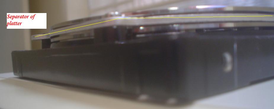

Hi to all!
Which the function inside of hdd of the Separator of to platter?
look photo!
:idea:

Damper???
Noise Reduction and maybe prevent we DR company tried to take off platters :lol: but we can get another methods to bypass it

I would choose "prevent DR companies from removing platters."
Sempre - what drive is that?

Looks like a Samsung SP drive to me, I had one like that. :-(

Hi model SP1644N SAMSUNG!

i think it is to direct air flow and to stabilize the platters, not to prevent data recovery recovering data as they dont gain anything but adding costs to the hdd.

Somebody knows here if binding hdd without the separator of platter it can function?
somebody already tried?

hi sempre, yes it will work but recommended only for a short period of time to get the data out.

Hello friend terranova, Damper function on Samsung HDD its for reduce vibrations, and noise, check, it
http://www.patentstorm.us/patents/7327530-claims.html
