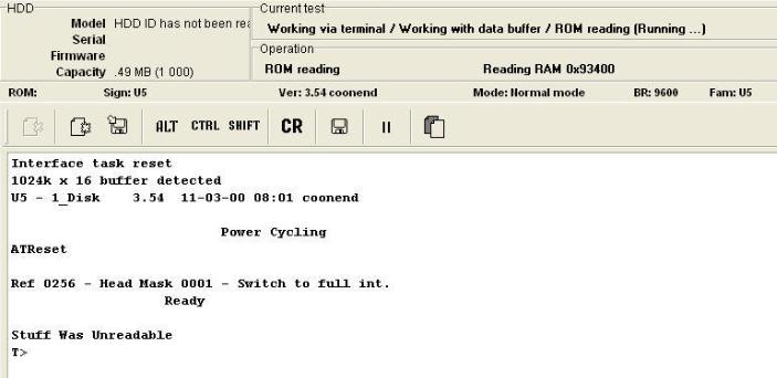

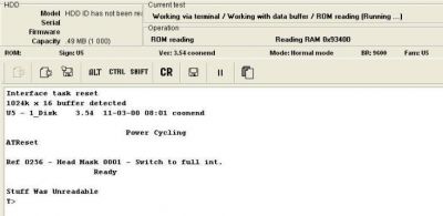

Hi to all!
My problem is model ST320413A
FW: 3.54
POWER ON, IT IS FOR 20 SECOND BUSY And LATER HE IS NOT READY...
CHANGING the PLATE IT CONTINUES WITH SAME the CHARACTERISTICS...
Thanks..

terminal report
Interface task reset
1024k x 16 buffer detected
U5 - 1_Disk 3.54 11-03-00 08:01 coonend
ATReset Power Cycling
Ref 01EC - Head Mask 0001 - Switch to full int.
Ready
Stuff Was Unreadable
T>

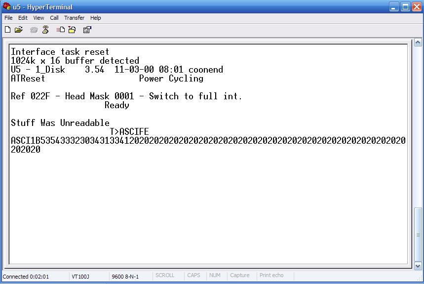

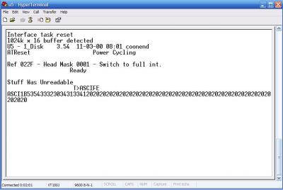

 Post subject: Re: SEAGATE U5 20 GB
PostPosted: April 23rd, 2008, 9:11
Posts: 1060
Look!
thanks

Hi to all!
Please,
How I can rapair this problem for recovery data?
Thanks!
U5 PCI.txt [214 Bytes]
Downloaded 672 times
PostPosted: May 23rd, 2008, 15:52
Posts: 2288
Location: In ur HDD !
Type :
T>F
Setstuff>ASCIFE
