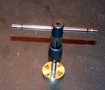

Hi all,
another day, another seagate.
I've a 320GB Barracuda 7200.10 here, error: spin motor locked.
It squeals while trying to "buzz" and the stops with the above message.
The current waveforms to the spindle motor look ok on the oscilloscope.
From your experience, what shoud I expect: head stick onto one surface or bearing?
The drive was in an external enclosure, so my guess is that it got rather hot.

Motor bearing seizure is fairly common on this model.
Even if you manage to free the motor, the vibration from the bad bearing may make it practically impossible to image the drive.
I've made a tool to free the motor, but haven't yet been able to read the data.
Seagate's dampeners between the platters makes platter swaps undoable for me.
Jon

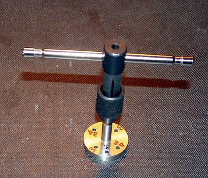

Could you two please give me a hint what kind of tool you use for freeing the motor?
Times are gone when we opened full size 5,25" "winchesters", turned the power on and helped turning by hand I guess :)
 Post subject: Re: Barracuda 7200.10: Spin motor locked
PostPosted: April 11th, 2008, 10:39
Joined: June 8th, 2006, 19:44
Posts: 3144
Location: Atlanta, GA
Here is one for WD, Seagate, & Maxtor
http://www.datasaversllc.com
Jon,
You always keep making surprise and full of aspiration.
Even It looks similar like a complex flask opener. I believe it is easy to use and can free Motor bearing seizure.
You can make more research and find a solution of vibration of platters when freezing the motor.
I will wait for your next generation flask opener, oh, no, your motor seizure unlocker. :D

salvationlaura wrote:
Jon,
Laura Lee
Hi Laura,
Nothing too mysterious or high tech about my "flask opener."
:lol:

I have seen many 7200.10 series with motor problems, some i managed to free the motor but some were totally dead locked.
Pepe, did you use a tool similar to Jono to free the motor? or you have something else?
Jono, with your tool..did you just keep turning the motor until it loosen a bit?
PostPosted: April 14th, 2008, 0:47
Posts: 3144
Yes.
PostPosted: April 14th, 2008, 4:11
Joined: April 4th, 2008, 5:49
Posts: 42
You have to use some patience... sometimes is a long work. A way to reduce vibration when it is almost free is to start motor with the open case, and stop when the spin reach right speed, one moment before heads start to move. You will find right moment with some experience. Start and stop again and again. Every time you will have less vibration. And, don't forget to fix it in some way during recovery... or it will jump off the table (suicide drive ?) !!!
