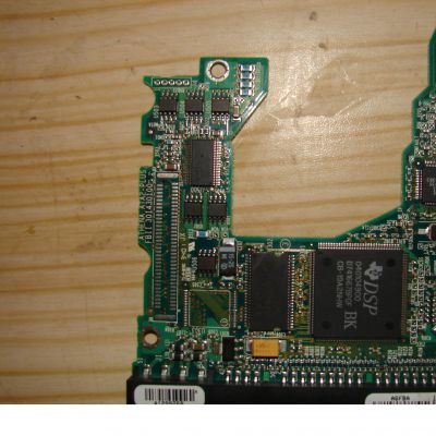

Hi Experts,
I've the following Maxtor harddisk which had its PCB burnt.
I've the Donor PCB which is compatible with my patient drive.
Let me know which is the firmware/rom chip I need to swap from Patient to Donor.
(Picture of the PCB attached)
Maxtor 20GB IDE
Model: 2B020H1
HDA: 11A
PCBA: 06A
Unique: 32A
Code: WAH21PB0
CT: 245C801H1MGALY
SN: B18W36JE
PCB: A6FBA
Thanks in advance,
RDS.

ROM is masked in the DSP processor, there's nothing to change. If the donor PCB does not work instantly after swapping, there is a miscompatibility issue here.

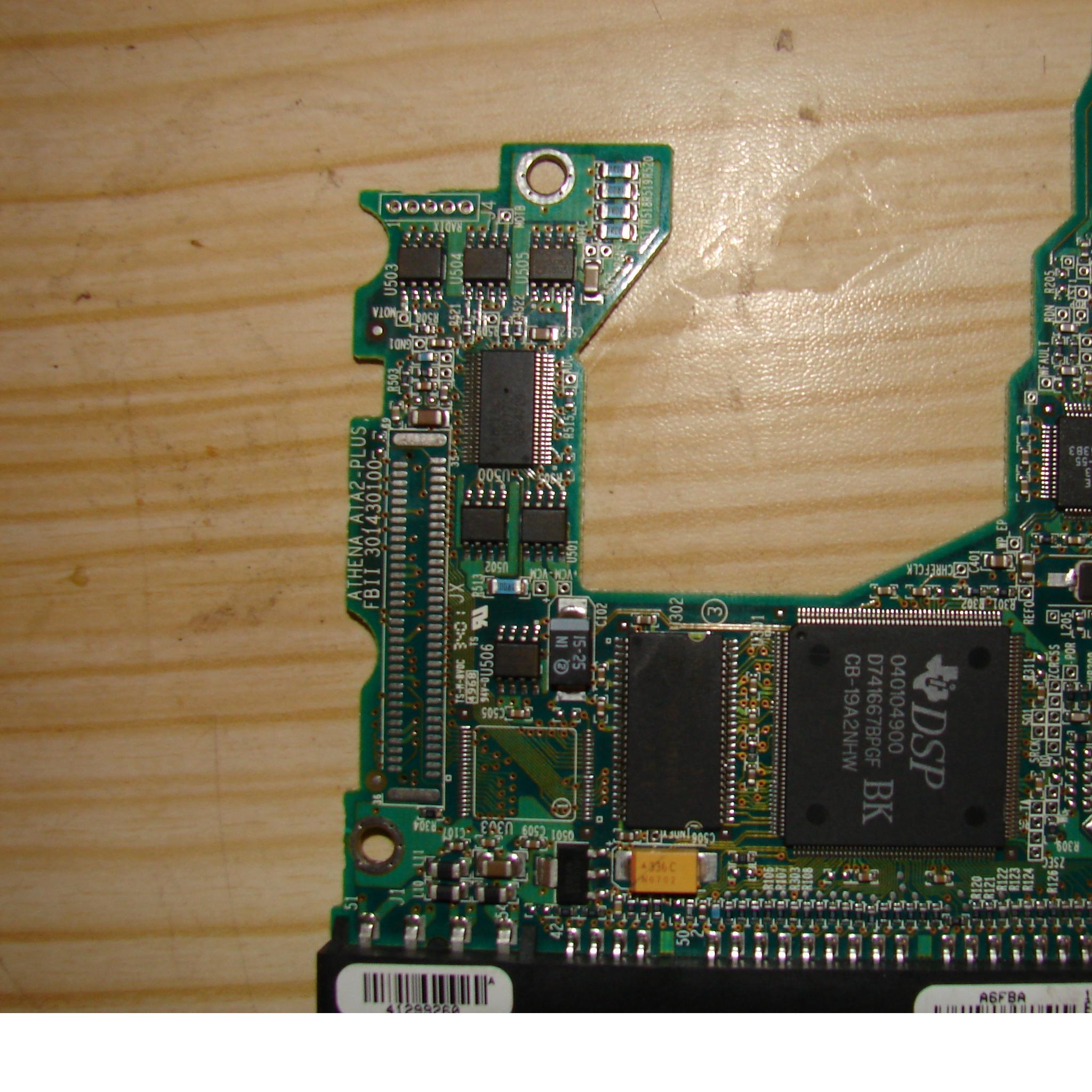

Which PCB did u put on the hdd .
There isnt any compatiblity issue in athena pcb any pcb with DSP chip should work on it . Could be a preamp issue .

The Donor PCB is also a Athena PCB only with PCB firmware rev: A6FBA.
After using this donor PCB only, it started spinning and detecting in the BIOS but 0MB size, wiht clicking sound.

Hi
if it is clicking with that PCB, probably head or preamp is dead.

It is quite common for heads to fail along with a PCB burn out. One generally causes the other. Your burn does seem small htough. Most of the damaged heads and PCB occur with major PCB burns. Especially Western Digitals
