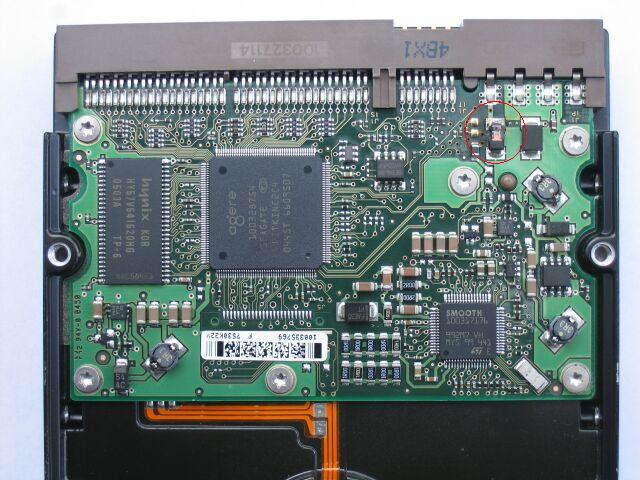

Hello HDD-Gurus,
I think, during insatllation of my HDD Barracuda 7200.8 in an other PC-tower, a device on the PCB was damaged (This I realized, when I took out the HDD and had a closer look to the PCB), so that it burned through by starting the computer.
In the attached picture you can see the PCB with the marked damaged device.
I think, only the PCB is damaged and not the HDD itself
Now it would be nice to find a cheap way to rescue the data stored on the HDD. I think of two ways and perhaps you can help me.

 Post subject: Re: Seagate Barracuda 7200.8 (ST3300831A), Device on PCB damaged
PostPosted: May 2nd, 2008, 11:08
Posts: 935
Location: NJ
It's probably best to just replace the defective part. The part you circled is a protection device, and the rest of the drive is fine if it did it's job properly. You can use the part from your donor drive. Just be sure to put it in the right way. Or, you can read the number off the part, and buy it online. This is a Surface Mount part, which is standard, just not commonly found in local Electronics stores.
PostPosted: May 2nd, 2008, 11:26
Joined: June 8th, 2006, 19:44
Posts: 3144
Location: Atlanta, GA
The part probably blew because you have a badly regulated power supply. Fix that first.
You can remove the burned part; the drive will spin up, and you can recover your data.
PostPosted: May 4th, 2008, 13:31
Joined: May 2nd, 2008, 9:09
Hello together,
thank you for your support. As suggested I removed the damaged part and the hdd worked so that I could rescue my data :D
So everything is fine and I even didn't have to tuche the donor drive.

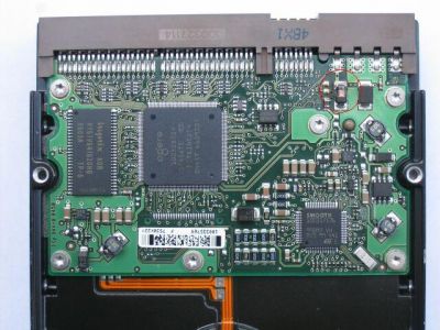

But just for intrest:
rchadwick sugested to replace the damaged device. I had a look to the donor hdd an found the following descrition on the device:
In the first row
ON (in a circle) QE
in the second row:
R546.
(see picture)
If I want to buy this part, what is it and where can I find it? (What can I serche for in the internet?)
Best regards
File comment: what ist this?
PostPosted: May 4th, 2008, 20:52
Posts: 935
Location: NJ
I'm assuming you want to return the drive to service. The easiest way would just be to scavenge the part from a dead drive. Assuming you don't have dead drives laying around, you can get this part from Digikey. The QE signifies the actual part. ON in a circle means On Semiconductor, which is the manufacturer. The R tells where it was made. The 5 is the year, and the 46 is the week it was made. But what you're really interested in is a link, so here it is:
http://search.digikey.com/scripts/DkSea ... T3GOSCT-ND
You have to buy a minimum of 10, but they're cheap. I think Digikey charges you if you order less than $25 worth of stuff. You might find the part somewhere else. If you're really ambitious, you can look up the data sheet, and find another part that will be compatible.
