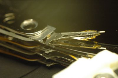

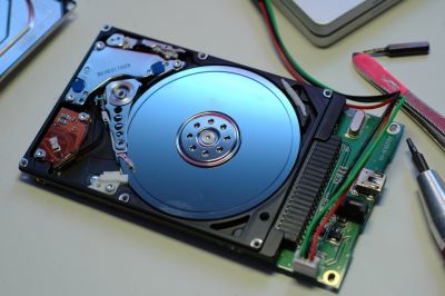

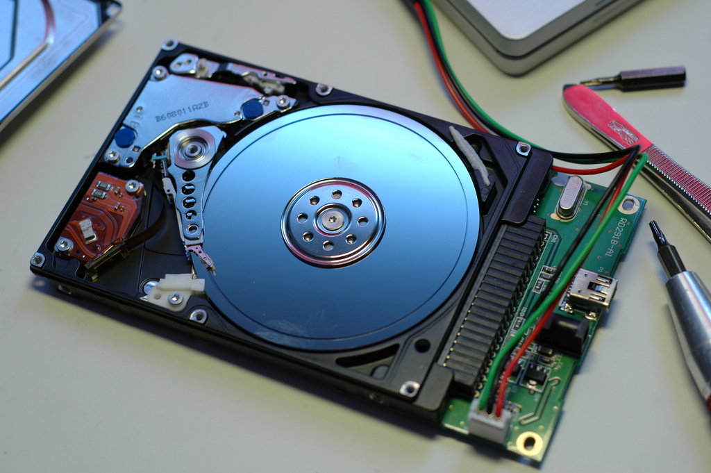

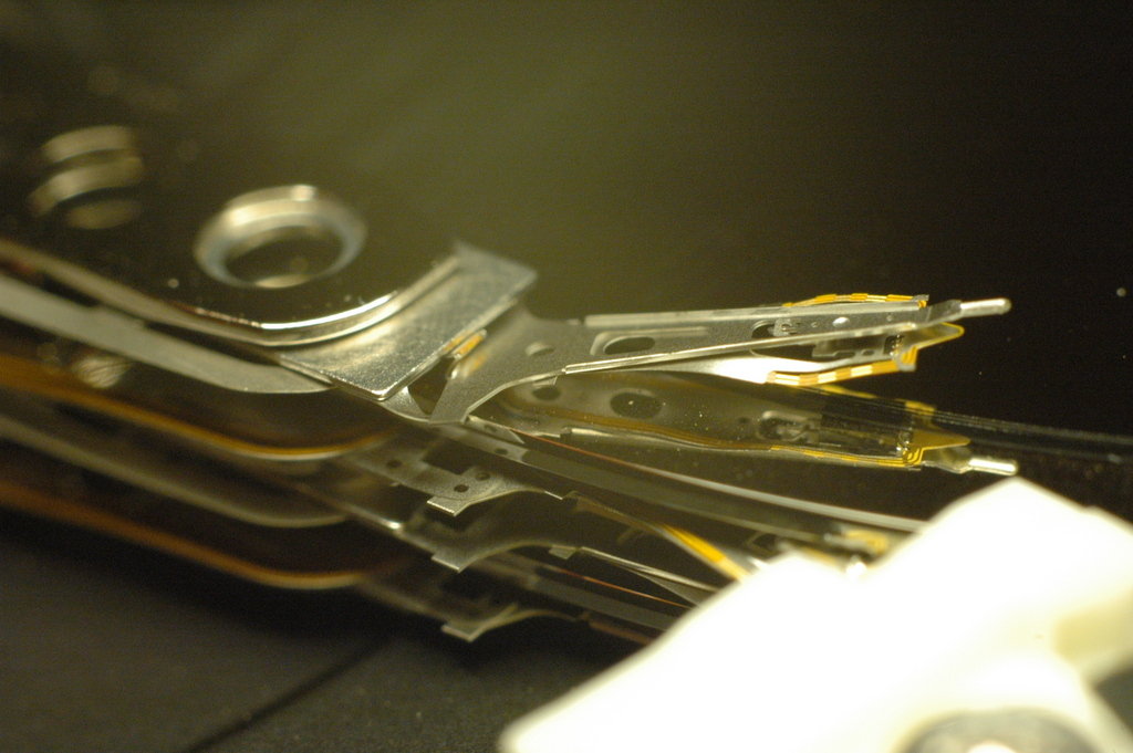

I've got a damaged Hitachi Travelstar 100GB 5400RPM (HTS541010G9AT00) laptop drive that suffered a fall. Upon opening, the top read/write head was bent under itself, which subsequently scratched a circle around the top platter. Attached are some photographs. I've ordered an identical drive in an attempt to either swap the platters or swap the head stack, but have never attempted either before.
Can someone give me some advice? Is data recovery within reach for this case?
(above) shows the circular scratch caused by the bent head, note, the fingerprints on the platter are not mine, someone else had a go at it before it got to me
(above) the bent head

You have a number of technical challenges that make this very difficult, if not impractical:
1. If the scratch is on the Service Area, forget it. (IBM 2.5" drives have SA tracks near the hub. Not 100% sure about Hitachi, but those two companies put out some joint product . . . ) The Service Area contains adaptive data for that particular drive.
2. You'd have to load the heads without letting them touch the bad tracks, or they would instantly self-destruct, and prevent them from seeking during operation to the damaged area. Note that a Hitachi drive will not start if the heads are parked on the platters, so you'd need to defeat that mechanism.
3. You'd also need to decontaminate the platters. No telling what damage the previuous fellow did that you CAN'T see.
I doubt many pros can get data from this drive; your chances would be a very small fraction of theirs. Try it if you want to experiment, but not if you need the data.

Hitachi says in its site that the head flight less to 0,5um (micron) from the platter. If you could have a look with an electronic microscope (I have some photos but sorry it is copyrighted material) to the scratch zone you could see a "canyon" with borders that are not flat, but higher than the platter "floor". There are also some "rocks" that are material coming from the "canyon". Your new heads, at the first trip on the platter, will crash onto the edge and the rocks. Phisically. There are some tricks to use in some models, but if you are planning to put the heads normally in the park zone and let them pass on the scratch you will have broken heads in seconds.

Well I bought a donor drive on eBay, practiced headswaps on some other drives (two 3.5" 20GB Western Digitals that both failed and one 2.5" 10GB Toshiba that was a success), and finally attempted the headswap on the Hitachi.
What can I say, it didn't work, but I figured I'd follow up here in case it helps someone else.
One thing I noticed was a degradation in the amount the new heads moved around on the scratched platter. The first time I powered up the drive, the heads moved around a lot and appeared to be able to read at least some data because the size of the drive showed up in my syslog (it was attached by USB). However, after trying a few more times, the heads seemed to move around less and less, so I suppose they got progressively more damaged the more I tried.
Thanks everyone for your help.
