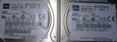

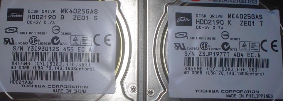

Hi to all!
These hds possesss the same heads? (compatible heads?)
Нет ничего невозможного
 Post subject: Re: HEADS
PostPosted: May 19th, 2008, 15:51
Posts: 4840
Hi
I always match country.
U may give it a try. Recently I used an MHA from an MK6026GAX made in CHina in a drive made in Philippiness.
The only thing that's worrying me about this is the fact that the 'Made in China' sign was printed on a separate sticker placed over the original that says Philippiness ... :)
PostPosted: May 19th, 2008, 21:08
Posts: 1517
Location: Mexico
Hy sempre, on my cases for head exchange on toshiba, i always tried to find matching between model HDDxx ZEXX and country,
Best regards
PostPosted: May 20th, 2008, 7:58
Posts: 1752
It's better to match country code, but if you have a donor from other country, try it, because I found toshiba very tolerant to that.
PostPosted: May 20th, 2008, 8:05
Posts: 872
Location: Dublin
I had the same issue last week. I did a headswap on non-matching country codes and unfortunately it didn't work. I tried it again with matching parts and it was 100%. However, I have successfully done headswaps on Toshiba's before where country code does not match.
So, to conclude, I dont know if there is a definite rule to say you can or cannot!
Data Recovery Ireland
PostPosted: May 20th, 2008, 16:16
Joined: November 28th, 2004, 1:54
Posts: 319
Sempre,
This drive has to be the easiest head swap in the DR business.
I don't have all my records going back all the years, but I do know I have successfully transplanted heads between drives manufactured in different countries. (Toshiba.)
Bear in mind that just the country of manufacture can often mean that the heads will be identical to those in drives manufactured in a different country.
Anyway, a very, very easy head swap - 3 minutes at most - so worth it for the experience if nothing else.
