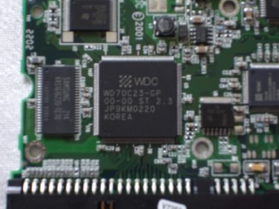

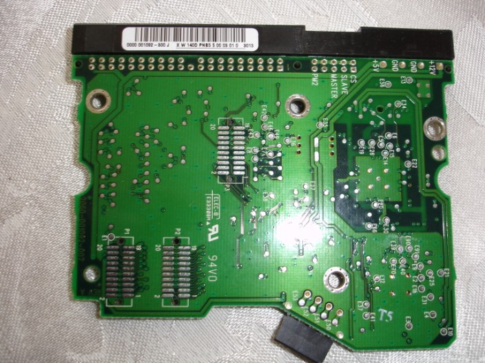

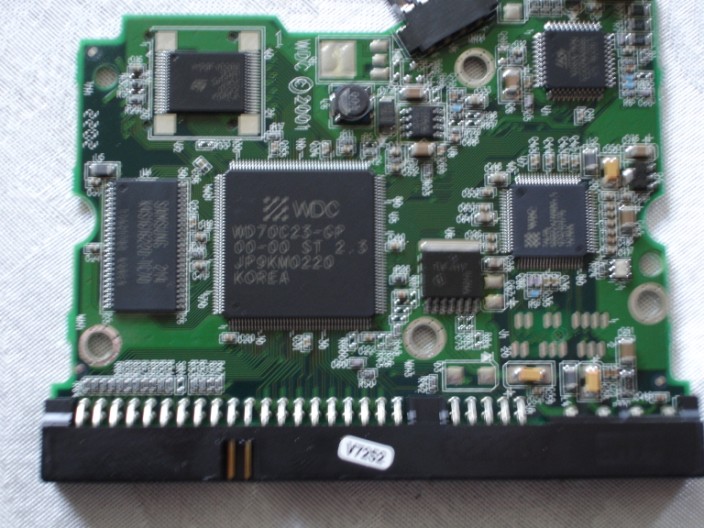

Got a drive in for recovery today. It's not recognized in bios at all. Worse yet, the customer at some point removed the entire label from the front of the drive. I have no model number, serial number, firmware revision, or anything.
Is there any way to indentify this drive so I can get a matching donor drive? Like i said, not recognized by bios or software solutions and I don't have a PC3000.
Any suggestions?

post some piictures of both sides of the PCB and the drive itself, let's take a look at it!

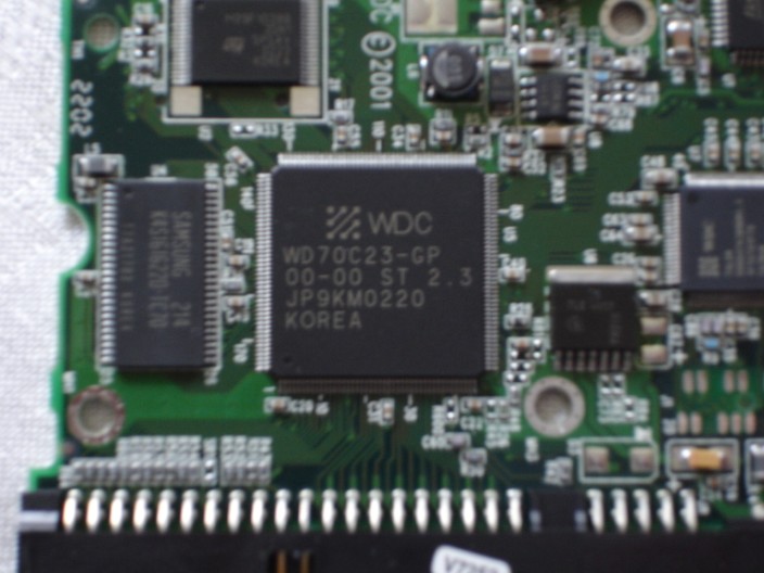

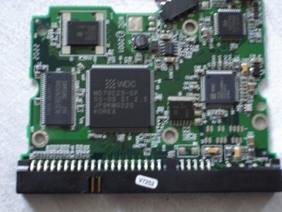

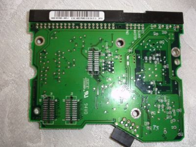

OK Finally got a few pics. They are not very clear, but the best i could get with my camera. If you need to know what any label or chip reads, I can tell you what's on it.
Thanks for the help.

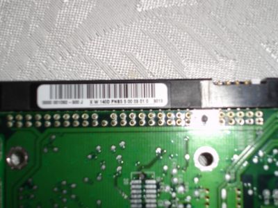

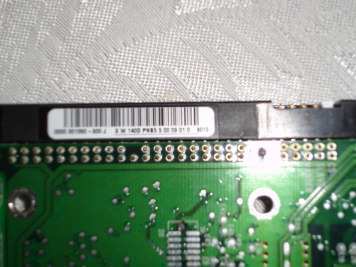

More

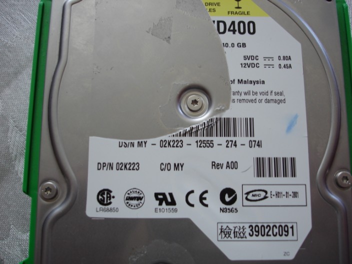

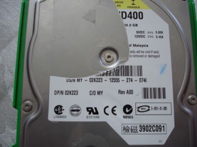

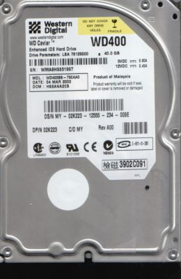

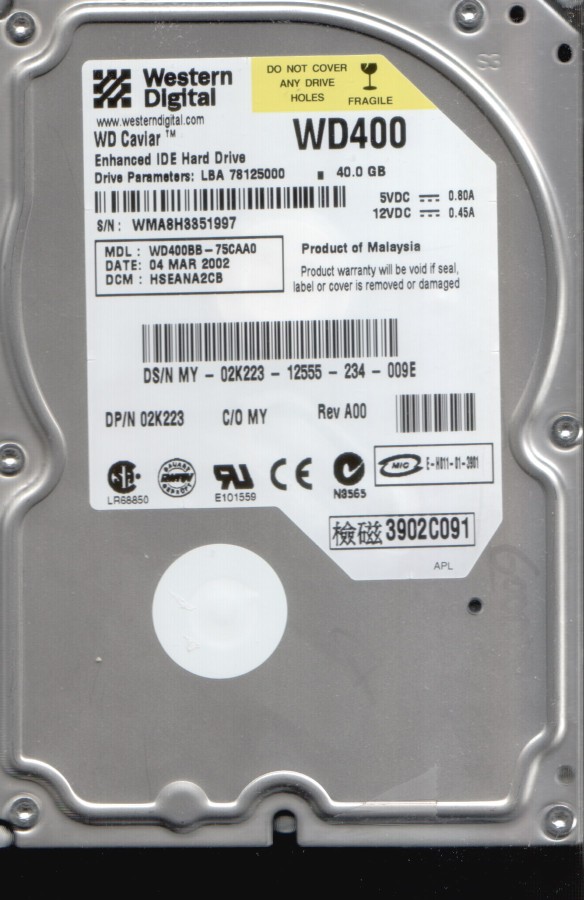

I happen to have this in my stock. The dell part number points to this model.

The serial number is also on the top of the drive opposite the ide connector. A close match to this one may give you your answer. Hope that helps. :mrgreen:

See my main problem is that I don' have the model number or the DCM number.
Now from pepe's pic, I can pretty safely assume the same model number because of the Dell p/n, but still no way to know the DCM.
From what I understand, it is important for the DCM to match as close as possible.
How do I determine what DCM I need so i can find a whole drive, or what specific PCB I need so I can search for just that?

The numbers on the back of the pcb (side that shows when fixed in place) on the white sticker are as follows:
0000 001092-300 J X W 140D PNB5 5 00 03 01 0 3013
