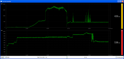

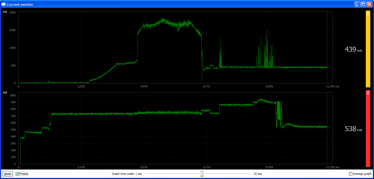

We do use amplifiers to amplify those mV (I thought it is kinda obvious) :)
The noise is taken care of as well. There's still some noise visible on the graphs, but it does not impact anything... Ok, I think I better just post an example picture :mrgreen:
(I guess this was a spinup current graph for an old SCSI hard drive)

OK, i see, this is really good solution. :)
