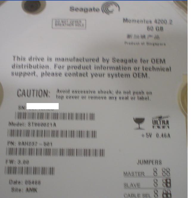

Hi to all!
Please, how I can increase my possibility to have one head compatible for this model?
What I must combine?
:vo:
Thanks!

Answer is on the "Articles" page under "Head Stack Replacement" :shock:
Ok, thanks my friend!!
but with the time and the model it can have more details that only the experiences of ours gurus can make a great difference in the practical one!
If somebody has some information here to add in this in case that I am thankful!

On this cases, we tried to find donnor matching , all Model, Site code, FW; Country, etc, on first check platters, there are some cases on head crash over Seagate 2.5" , the most cases its over Mac :( , and did the head swap on a clean room we find more sucess on that situation
