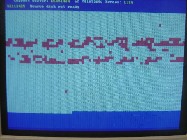

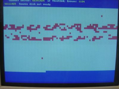

Try my suggestions. R Studio can be easily set up for one read retry before moving to the next sector. This is instead of the usual 32 attempts for each bad using Media tools.
The Copyr.dma utility is also worth a try. It automatically skips the bad sectors. Might still take a few days to complete a full image. You would directly image to a replacement drive. I'm not sure how or even if it works with a Sata drive or if you need to use ide interface adapters etc. Its worth a play!
http://www.softpedia.com/get/System/Har ... -DMA.shtml
Info says 128gb drive limit and Sata not supported. Still with a sata to ide adapter it should work.
Attached is a pic of the last time I used it on a crashed drive. The damaged areas are clearly seen. Some but not all data was recovered.
