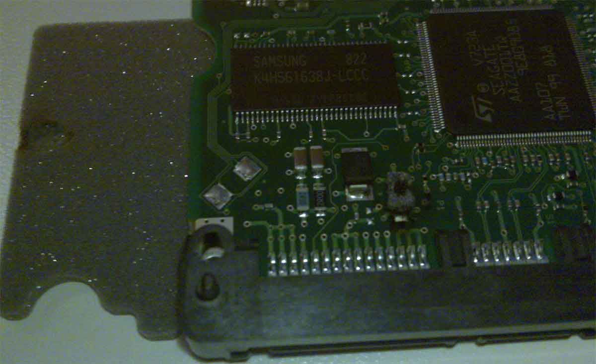

I have fried quite a few hard drives the last year due to bad luck/negligence and when i fried three of them just this weekend i decided to give it a go at recovering my data. I am pretty sure by reading here and looking at pictures posted by you guys that all of my disks have fried TVS. I am guessing its the 5V one because almost all of them have been fried after i used a power cord that had the 5V and 12V switched, the 5V got the 12V and the 12V got the 5V. I assume the 12V TVS wont fry when it gets 5V but the 5V would probably fry when it gets 12V instead of 5V.
Now theres one disk "Seagate Barracuda 7200.11 640Gbytes" that i am pretty sure has a fried TVS because of the smell of burnt electronics but since the circuits are turning towards the drive i cant actually see the burned TVS without removing the PCB. As luck would have it i went to a computer store and i found a brand new identical drive and i mean identical, right down to the date and site code, everything matches, thy are like identical twins =) and my question is this. Would you guys switch the PCB or would you first try removing the TVS on the original PCB and if that fails then try switching the PCB:s? To get to the TVS on the PCB i would have to remove it anyway, i am just worried that the PCB might get damaged or something when i am handling it.
I am going to try removing the TVS from another drive that has a fried one just as a test before i go at it with the more important drives.
How good would you say my odds are if the only thing thats fried is the TVS and i do a PCB change with these identical drives?

Sounds like a TVS. PCB change probably wouldn't do the trick due to adaptives etc. I'd suggest to take the PCB off, take a picture of the component side and post it. Then you can get a better answer.

Well i am happy to tell everybody that i managed to recover the data from the drives and it was the TVS that was fried on all of them, i just removed it and they came alive again.
This is the TVS of the 640gig drive, i am going to remove it now because it went so well with the other drives =)

A better question would be why are there no voltage regulators on external hard drive boxes to prevent you from frying them with laptop power supplies. Price. Will you pay extra for an enclosure with a voltage regulator? Will you pay more for a better quality power supply that will actually look good on a scope? Most won't.
A TVS is a form of a fuse. It's simply not an end user part. It fails for a good reason and usually the drive can't be considered reliable after that event anyway.
