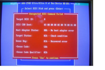

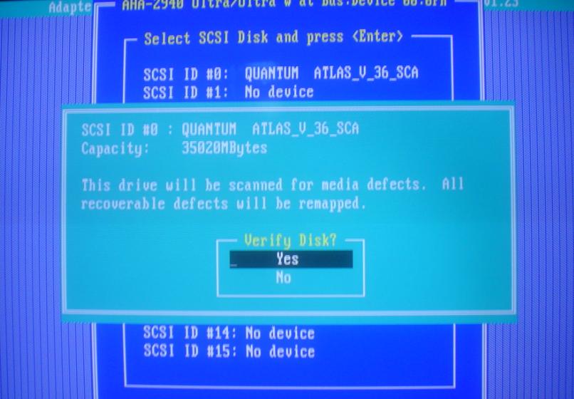

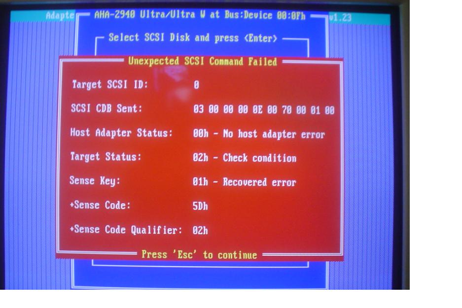

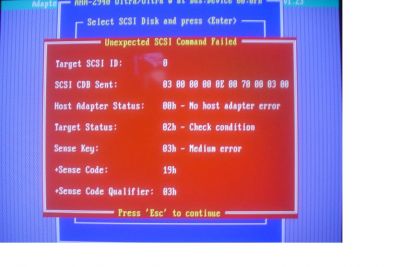

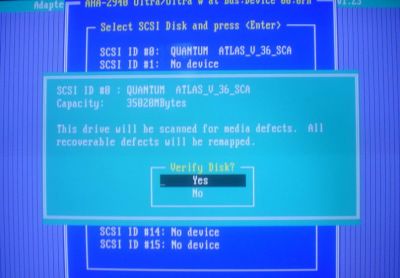

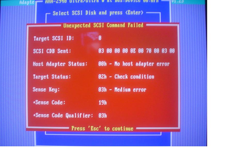

 Post subject: Re: HD SCSI ATLAS V NOT READ
PostPosted: June 6th, 2008, 14:55
Posts: 1060
Look!
PostPosted: June 6th, 2008, 16:14
Posts: 3598
Location: Chicago
031903 error means - "Medium error. Bad Grown Defect List"
