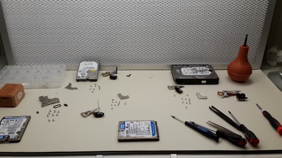

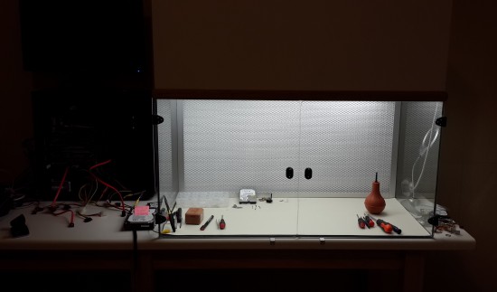

 Post subject: Build an home made class 100 air filter
PostPosted: August 14th, 2013, 7:18
Joined: June 25th, 2013, 10:18
Posts: 70
Like title suggests:
What material can be used to have the filtering power of a Class 100 filter ?
 Post subject: Re: Build an home made class 100 air filter
PostPosted: August 14th, 2013, 10:49
Joined: September 1st, 2007, 14:39
Posts: 101
Location: Finland
As far as I'm aware the filter is not the problem. The main idea is to make the air flow laminar not turbulence. Or have I misunderstood it all?
 Post subject: Re: Build an home made class 100 air filter
PostPosted: August 14th, 2013, 11:10
Joined: June 25th, 2013, 10:18
Posts: 70
What I'm doing is just for learning something.
I want to use an homemade Glove Bag (use Google Image to see examples of it) to open a damaged hard drive and look for scratches on platters surface and maybe try head exchange.
The Glove Bag should have two holes: one to extract the air with dust with a vacuum cleaner and another one with a filter for clean air intake.
This is why I'm asking a suggestion for a filter that can achieve Class 100 level :mrgreen:
 Post subject: Re: Build an home made class 100 air filter
PostPosted: August 14th, 2013, 11:15
Joined: June 25th, 2013, 10:18
Posts: 70
Glove Bag Examples:
 Post subject: Re: Build an home made class 100 air filter
PostPosted: August 14th, 2013, 14:28
Posts: 293
uuuh, just a couple of points:
1: Aren't those plastic bags an inflatable type? So ... sticking a vac on them .....?
2: plastic bag: ESD safe ?
that aside,
If you are opening drives just to practice assembly / disassembly, it's not worth the hassle. Just do it. Grab ebay "spares or repairs" el cheapo.
Kern
Голод не тётка!
 Post subject: Re: Build an home made class 100 air filter
PostPosted: August 14th, 2013, 14:40
Ma il tutto è solo per fare esperimenti o vorresti usarlo su drive di clienti / non tuoi ? In tal caso prevedo guai...
All this is just for fun or are you planning to use such stuff on customer / not own Hdd ? If so, I foresee troubles...
 Post subject: Re: Build an home made class 100 air filter
PostPosted: August 14th, 2013, 17:06
Posts: 922
http://www.youtube.com/watch?v=p8DydHVy8Zo
Of course just for fun :D
 Post subject: Re: Build an home made class 100 air filter
PostPosted: August 15th, 2013, 6:38
Joined: June 25th, 2013, 10:18
Posts: 70
BlackST wrote:
All this is just for fun or are you planning to use such stuff on customer / not own Hdd ? If so, I foresee troubles...
This is just for fun/learn.
No advice on what material to use for the air filter ?
 Post subject: Re: Build an home made class 100 air filter
PostPosted: August 15th, 2013, 7:57
Honestly I stick up with professional solutions so I can't tell what it is good for "having fun with". Professional filters are not "simple" , that's why they cost quite a lot and have a limited life depending on environment and what you do.
In any case, if your idea fails or has a flaw somewhere, you'll likely contaminate the drive "under test" so you'll likely have a head crash and you'll never know what was the cause, if it was the drive itself or something else.
So it is pointless : experiment and refine what is good discarding what is not. I don't see any other option...
 Post subject: Re: Build an home made class 100 air filter
PostPosted: August 15th, 2013, 12:11
Posts: 17320
glhd wrote:
No advice on what material to use for the air filter ?
HEPA
 Post subject: Re: Build an home made class 100 air filter
PostPosted: August 16th, 2013, 6:26
Joined: June 25th, 2013, 10:18
Posts: 70
Now that I remember, I have a 3M 8835 FFP3D class filtering respirator that would filter out at least 98% of the airborne respirable particles...
Home made clean room for few dollars :mrgreen:
 Post subject: Re: Build an home made class 100 air filter
PostPosted: August 17th, 2013, 11:53
Posts: 4001
The particles aren't going to magically go to the respirator just because it is there, you need a way to supply clean air while not blowing anything that is in there around. It is not as easy as you first think it would be, and by the time you hack together something good you could have just bought one
 Post subject: Re: Build an home made class 100 air filter
PostPosted: August 19th, 2013, 4:36
Joined: June 25th, 2013, 10:18
Posts: 70
HaQue wrote:
The particles aren't going to magically go to the respirator just because it is there, you need a way to supply clean air while not blowing anything that is in there around. It is not as easy as you first think it would be, and by the time you hack together something good you could have just bought one
This is why I've spoken to extract the air with dust with a vacuum cleaner
 Post subject: Re: Build an home made class 100 air filter
PostPosted: August 19th, 2013, 5:16
Posts: 293
HaQuE mate,
I want to build my own home brew operating theatre ......... i haz a plastic bag and a dyson.
Голод не тётка!
 Post subject: Re: Build an home made class 100 air filter
PostPosted: August 19th, 2013, 5:54
Joined: June 25th, 2013, 10:18
Posts: 70
digitalferret wrote:
HaQuE mate,
I want to build my own home brew operating theatre ......... i haz a plastic bag and a dyson.>.<
Yes, maybe you want to use this for self kidney removal and sell your organs on Ebay...
A new business idea for you :lol:
 Post subject: Re: Build an home made class 100 air filter
PostPosted: August 19th, 2013, 7:07
Posts: 293
why not indeed, the worlds newest hobby.
FIY. (fix-it-yourself)
have fun dude, i'll keep my organs tho. *8)
Голод не тётка!
 Post subject: Re: Build an home made class 100 air filter
PostPosted: August 19th, 2013, 7:26
Joined: June 25th, 2013, 10:18
Posts: 70
digitalferret wrote:
i'll keep my organs tho. *8)
Good choice, glove bags can be dangerous toys in the hands of people without the proper expertise and with strange ideas :wink:
 Post subject: Re: Build an home made class 100 air filter
PostPosted: August 20th, 2013, 0:17
Posts: 4001
I think F.I.Y. is F$%* It yourself
 Post subject: Re: Build an home made class 100 air filter
PostPosted: August 20th, 2013, 3:41
Posts: 1038
Location: South Africa
It's possible to build a safe working environment yourself, DIY, if you're prepared to put in the time and use the correct components. In the past I've build a work environment which uses a Class 14 HEPA panel, 2x Vortice fans with pre-filters. The joy of building an environment yourself is that you can spec it up to your own requirements in terms of lighting, anti-static precautions, air flow, etc.
Images attached for interest's sake.
20130627_205908.jpg [ 1.4 MiB | Viewed 13609 times ]
20130627_213311.jpg [ 2.32 MiB | Viewed 13609 times ]
Data Recovery Cape Town
 Post subject: Re: Build an home made class 100 air filter
PostPosted: August 20th, 2013, 5:50
Posts: 293
Proper job ! (Cornish exclamation of approval)
Голод не тётка!
Users browsing this forum: Google [Bot] and 217 guests
