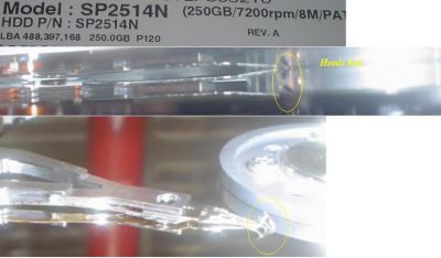

Hi to all!
Please opnion of gurus:
1)it is possible to restore these heads for recovery data of this hdd?
Yes as? in pm
Thanks!

Location: canada
no onces the head gets damaged or touch together
you need to replace it from a donor drive

Thanks all reply!
All heads are damaged, have some technique in removing them without damaging more platters?
Thanks advance!

Hi my friends!!!
To find a giver of heads for this model what I must coincide model, fw? what more?
Forth character in the alphabetic code printed on the label at the rear side od the drive should match
no letter and yes p120
Thanks all
Thanks!
