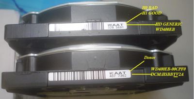

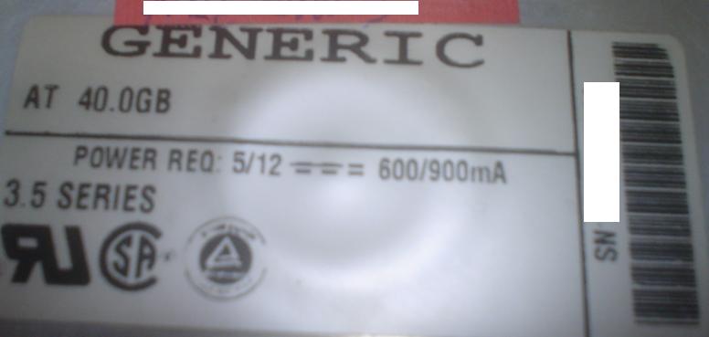

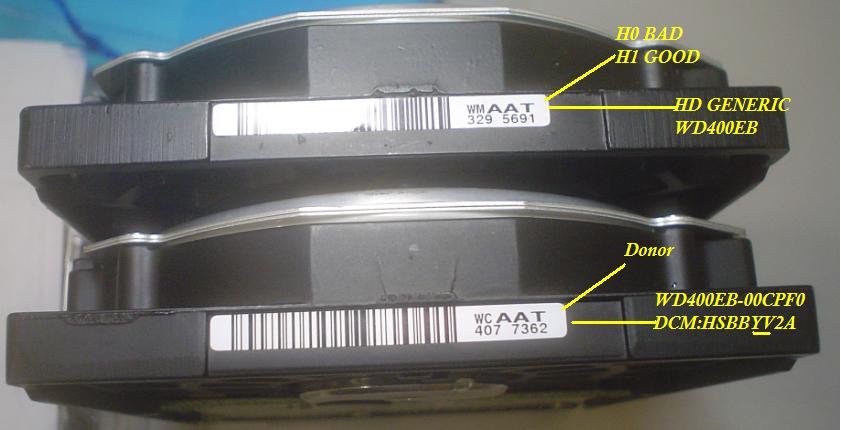

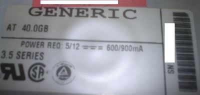

Hi to all!
"In the alphabetic DCM code the sixth (and quite desirably the fifth) characters must be identical"
:vo:
How I know that it is a compatible DCM?
Look photos!
:vo:
