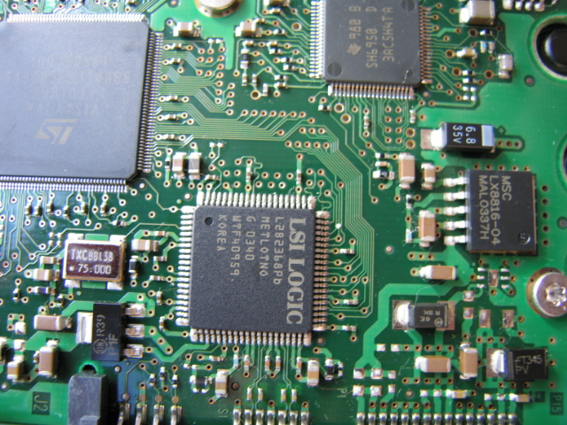

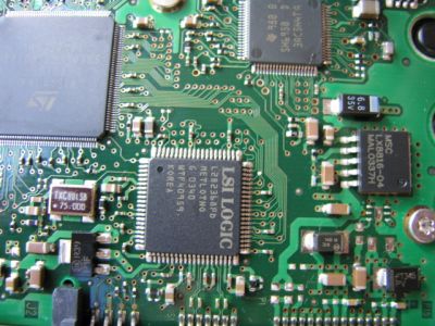

I am also attaching 2 pics.
1) while inspecing the board on one , it appears during manufacture two capacitors were stuck to the same part of the board? they are both firmly attached, I thought to begin with one must have come from somewhere on the board but appears not. Any ideas?!
2)second one is of the two diodes I tested.
File comment: Location of QE and FT345 , diodes presumably.
File comment: Two capacitors on one pad ?! looks abit dodgy!

I read the original post, and i can say, this was a spike, comes over the PS. :( (something like ESD issue)
The seagate's preamp is really sensitive for voltage rising.
I suggest, to check the two preamp for short circuit, before trying another pcb.
(maybe only damaged, but not shorted)
If you are lucky, the eeprom stay OK on the pcb, but another parts are too hard to test. :(
I think you need to find the closest pcb, and swap the eeprom, and/or the MCU, if the preamp is OK....

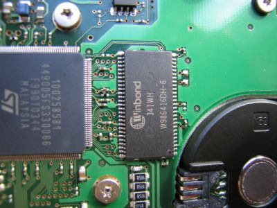

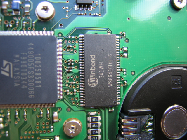

Any ideas why 2 caps on one pad, centre of image, between Winbond and ST chip (please click on it to see bigger) ?? Anyone seen such a thing before?
 Post subject: Re: 2 x Seagate ST380013AS 7200.7 80Gb simultaneous power failur
PostPosted: July 5th, 2008, 12:20
Posts: 1466
Location: Europe, Hungary
This is only the manufacturer's solution.
Maybe price....
Janos

On the other drive is only one cap in that place, looks like there pick & place machine screwed up making it?
PostPosted: July 6th, 2008, 12:40
Posts: 935
Location: NJ
It could be. However, manufacturers often make design changes after a PCB has been designed, and try their best to fit the part on the existing board, instead of having a new design made up. Back in the old days, I've seen wires added, and other parts glued on.
Either way, it looks like a low value capacitor, and likely won't hurt anything, especially if the drive did work at one time.
