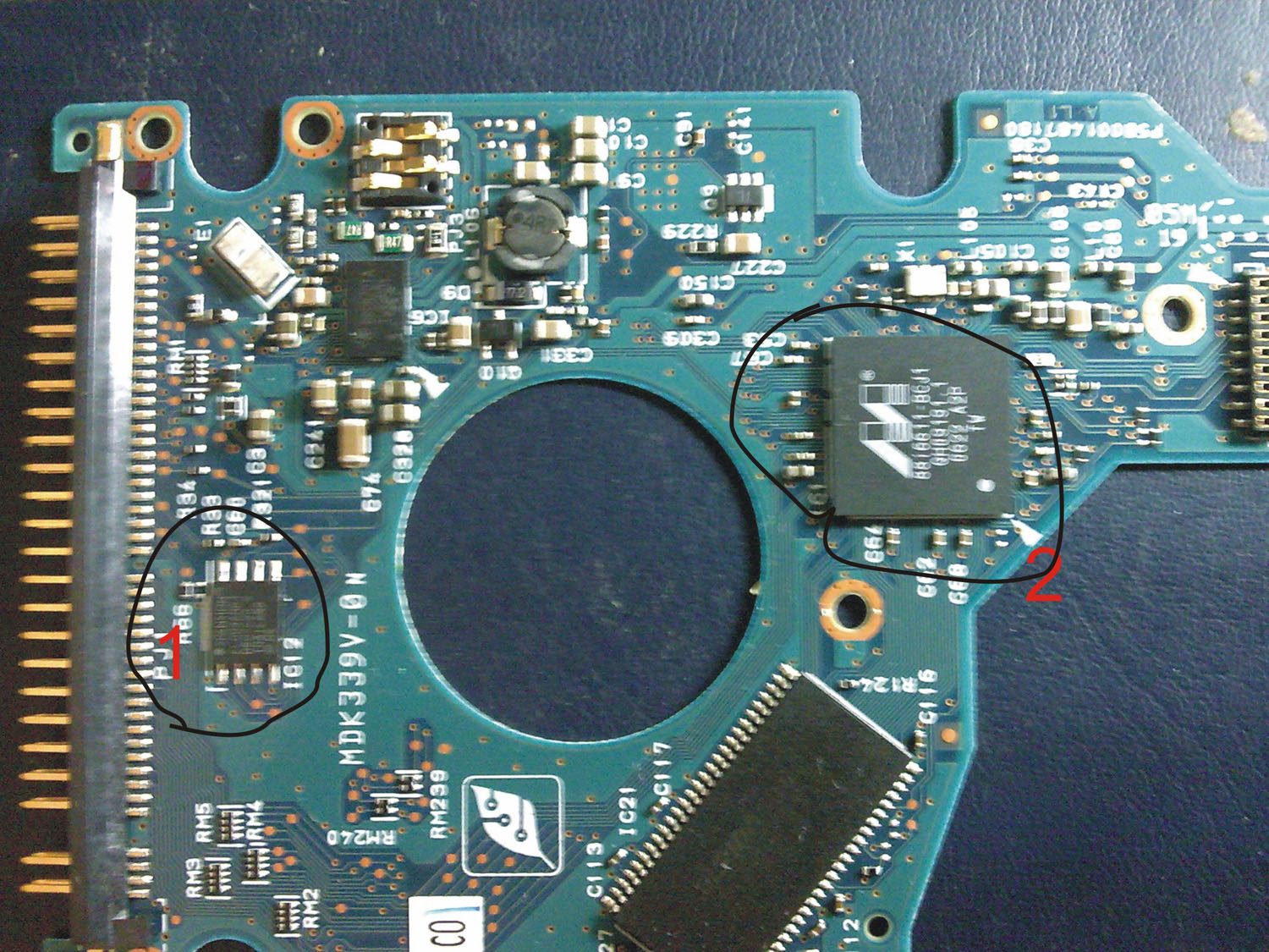

i got this drive and the head is stuck.. fix done
but it can't spin. then i try to test the PCB, no output power from 4 point that connect to the motor.
i search for the donor and got it. all are same only SN is different.
i am not sure that i can just swap the PCB or not. i heard that i must solder and unsolder ROM Chip or CPU.
can you help me which one the ROM that i must unsolder n solder to donor pcb.
no. 1 or no. 2
File comment: MK8032GAX PCB
thanks before

It's #1. You're lucky . . .

thanks jono. i will try it..

if im right number two chip is a bga type you wont be able to remove
as the solder is under the chip itself so no pins are shown
special tools can remove that chip like what we use :mrgreen:

tried it and succeeded. thanks to jono-ats.

the bga chip can be remove using blower or infrared solder.

yes correct but a lot of people just use a blower or painter stripper heat gun
which can damaged the ic again you wont get the perfect connectiong
infrared solder is what we use
