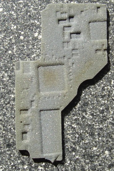

I'm intent on getting my data back and never using a Western Digital drive again.
The backside of the logic board was hot to the touch after the drive being on only a few seconds.
I removed the logic board to see if there was any identifiable burnt out parts on the logic board. It appears there was a foam strip put between the logic board and the hard drive. I am not sure of the purpose but it appears it did a great job at reducing airflow and keeping the chips on the logic board hot.
Picture will be in next post.

Note picture.
File comment: Notice burnt parts of foam, which acted as a blanket.

The PCB could be hot because of a problem inside the drive, which is why I asked if the drive spins up now. The board could be bad, but it could also be bad due to something else, and a new board may be damaged.
Whatever drive you get, it will likely fail. The solution is not another brand, but another strategy. Have everything important backed up.

looks like was the Microprocessor burned, send us an photo of the PCB , if u got Mp burned u got , big problem this model 5000AAKs has adaptive information inside

Ouch, I didn't notice the smaller imprint in the foam. Hot CPU with adaptives trapped inside is bad news. It's possible a regulator died, or something else is making the CPU heat up, and there is a slim chance the CPU is still good.

On the photo, looks like something is wrong with the power supply.
You have a very little chance to get alive again this drive.
The MCU (MP or microprocessor) looks like overheated, but this is not always caused by it is dead.
Sometimes the other components make the overcurrent on the MCU's output pins.
If the data is important, you need to find a pro to measure the pcb's component and/or recover the data.

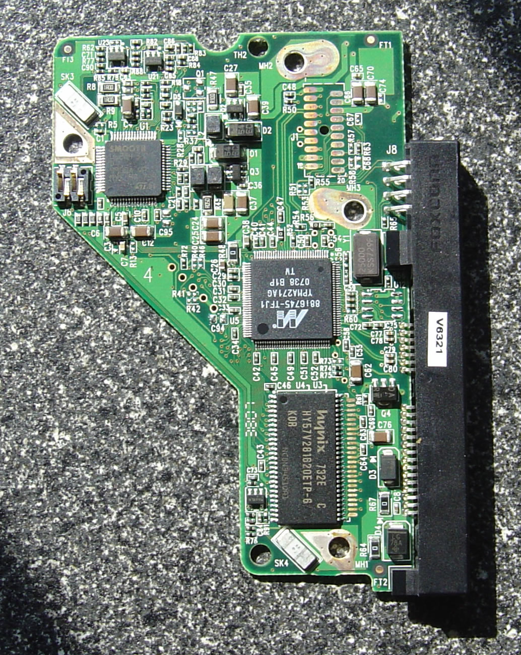

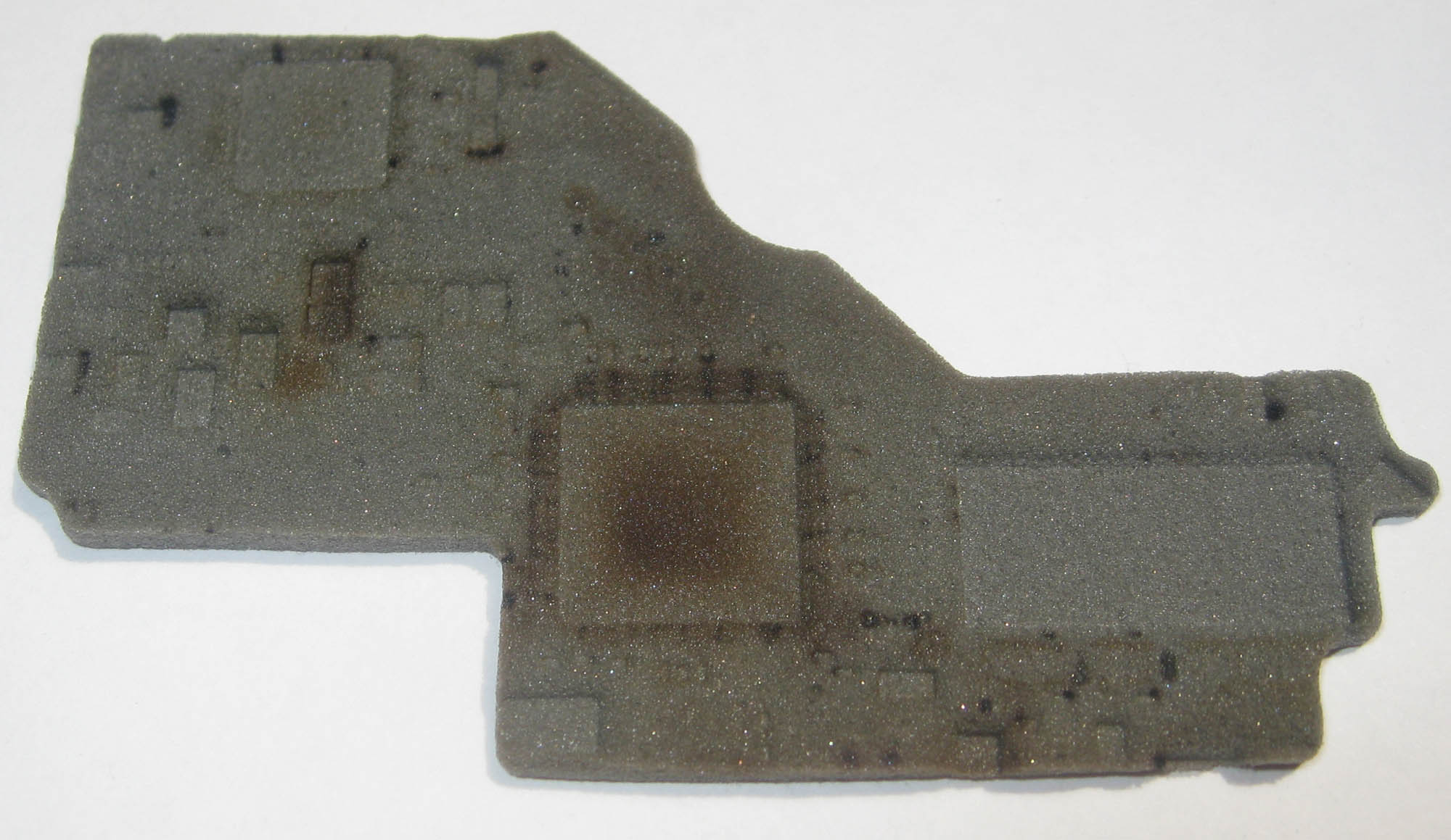

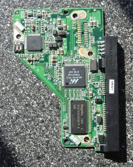

Hi guys I have a WD5000AAKS-07YGA0 with the same problem (I'm annexing pictures), do you think there is any chance that the MPU might be working?, the BIOS won't recognize the disk, the platters do spin but stop since the drive can't be initialized.
Also, I tried to replace the PCB with a similar one (from a WD5000AAKS-75YGA0, and only one difference on the PCB number, from 2061-701477-900 AD to 2061-701477-900 AE, also the last 5 digits from the DCM match from HANNNT2MAB to HBRCHT2MAB) without success, I'm aware that the firmware has specific data that is unique to the drive, do you think there is a chance of success if I get a drive with exact matching numbers to replace the PCB and hope that both are similarly calibrated? Or maybe if the original MPU survived then change it to the new PCB I already have?
Thank you in advance for all your help.
Oscar.
