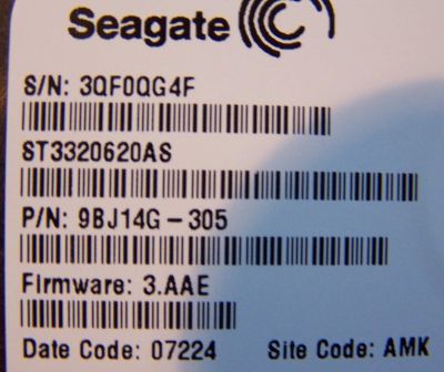

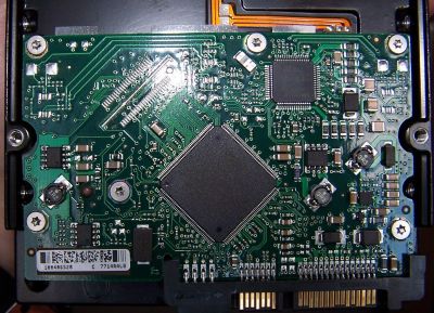

I am looking for a Seagate Barracuda 7200. 10 320Gbytes for swapping PCB with defect HDD.
model: ST3320620AS
P/N: 9BJ14G - 305
Firmware: 3.AAE
PCB number: 100406528 C 7714RAL8
Images are of the HDD with defect PCB

Hi
What's the number on the "Agere" chip?
I have a PCB which may be suitable, but you'll have to swap the ROM. (Which you'll probably have to do anyway)

Hi
I'm also in need of the exact same PCB, it's a friends drive and he broke the plug connector and a couple of pins.
Drive details:
ST3320620AS
P/N: 9BJ14G-305
Firmware: 3.AAE
Date Code: 07122
Site Code: WU
What do you mean by needing to swap the ROM as well? What's involved in that?

Posts: 249
if its just the connector, power or data, thats broken swap ONLY those bits from the donor PCB to yours. Don't swap the whole PCB.

Joined: August 11th, 2008, 18:24
unfortunately some of the pins have broken off the PCB, not sure how to replace just those without lots of fine soldering :)
