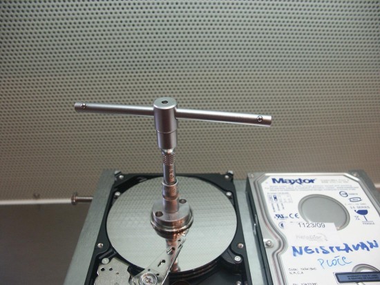

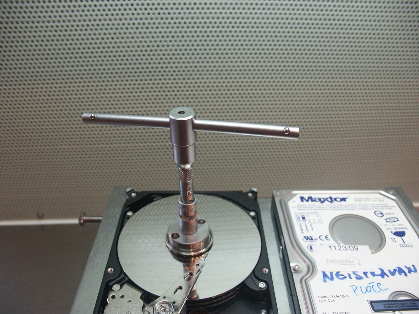

He needs something like this, again Help disc product heheh
nothing beats brute force...
there i a whay to take out the axel of the motor widouth taking of heads or platters but it needs a strong hand...

I can't see how using that method is safer than moving the platters. How do the other members deal with seized motors? Brute force or platter swap?
I vote platter swap.

brute force can work BUT the spindle will be OOB (out of balance) "probably"
WD works quite well with the BF style MAKITA hammer drill :mrgreen:
well who said it is not better....
desperate times need desperate messures, some times it is enough especialy on WD drives, on seagates exel in motor gets damaged....even BIG companies try to do it before they use sticky papper....
there are poepple who actualy do data recovery.....
Moving platters withouth traing to unstack the motor would be as traing to change heads withouth checking the pcb first.
 Post subject: Re: Seagate Barracuda 7200.11 stopped spining HELP
PostPosted: April 28th, 2009, 19:06
A seized motor when 'unlocked' will operate with considerable vibration or not full speed so reading is unstable and / or fail to ID - especially on Seagate and Samsung. I am critical about these methods, when unnecessary : better off move the pack to a known good motor.

... and many times the platters have invisible ~radial scratch what makes it even more problematic.
Anyway, there's no need to say anything more, this case is getting screwed up I think.
A tool is only useful in expert hands...
I have purchased this tool from Helpdisc, and today alone have recovered 2 Seagate Drive with spindle siezure, one was 7200.11. It is no substitute for platter swap, but is a effective method that in many cases gives good results.
