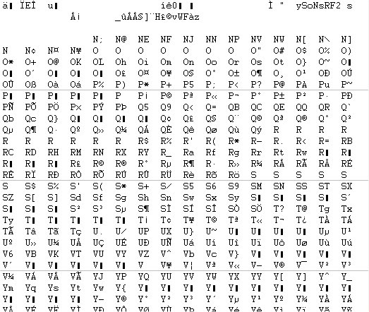

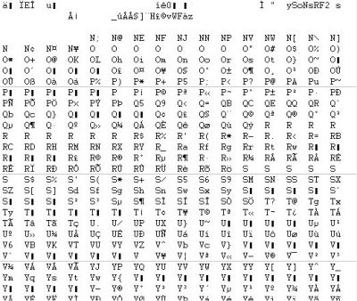

The starting sector looks like this:

What about sector 63?

That's actually starting at sector 128, 0-127 are blank.

Take a look at the first line of the picture in your attachement...at the end of line it's something like that "ySoNsRF2".....try to read the second letter first then the first letter, after that the fourth letter and than the third...etc...what u get?...SyNoRs2F
Exactly the same case like in your example...
So......
