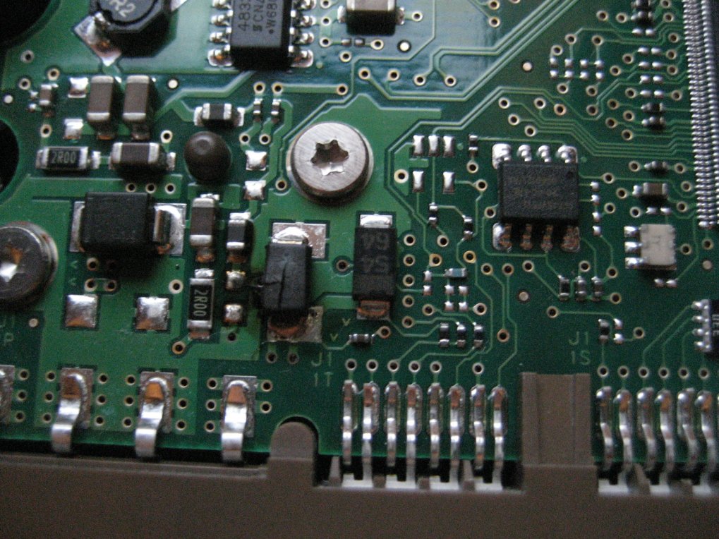

Hola i fried the PCB on the bottom of my seagate 500gb 7200.9 whats the odds of me getting this bitch going again? I basically think if i get a working PCB it should all be fine?

well it was an external and put the wrong power source in basically. when i opened it up you can see one of the lil black squares on the pcb cracked with a burn mark on the casing. i dont know whether i should just give up on it the info aint that important i just miss it

ok taken the pic im excited about the prospect of it but where do i find components and how do i work out with one i need? u guys are pretty great btw , not gay , well not yet
File comment: in the middle bottom its easy to see

That component can simply be replaced with a donor component found on a working PCB. In fact, depending on the model of your 40GB Seagate there may even be the possibility of using a component from that HD.
Do you have any equipment for soldering? Hot air gun, tweesers?

It is a TVS diode, very common to fail, and relatively simple to fix assuming you have the required skills. Im pretty sure if you search this forum for TVS you will find much more information.

As far as I see this baked TVS is on the 5V line. If it wasn't strong or quick enough, the surge could easily reach the preamp inside the HDA making it impossible to recover the data with just a pcb swap.
Sorry for the bad news.
