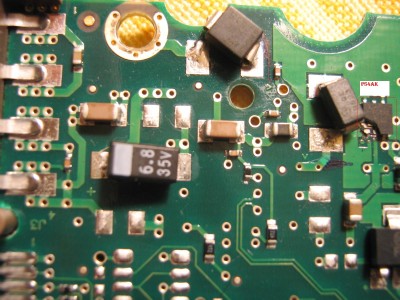

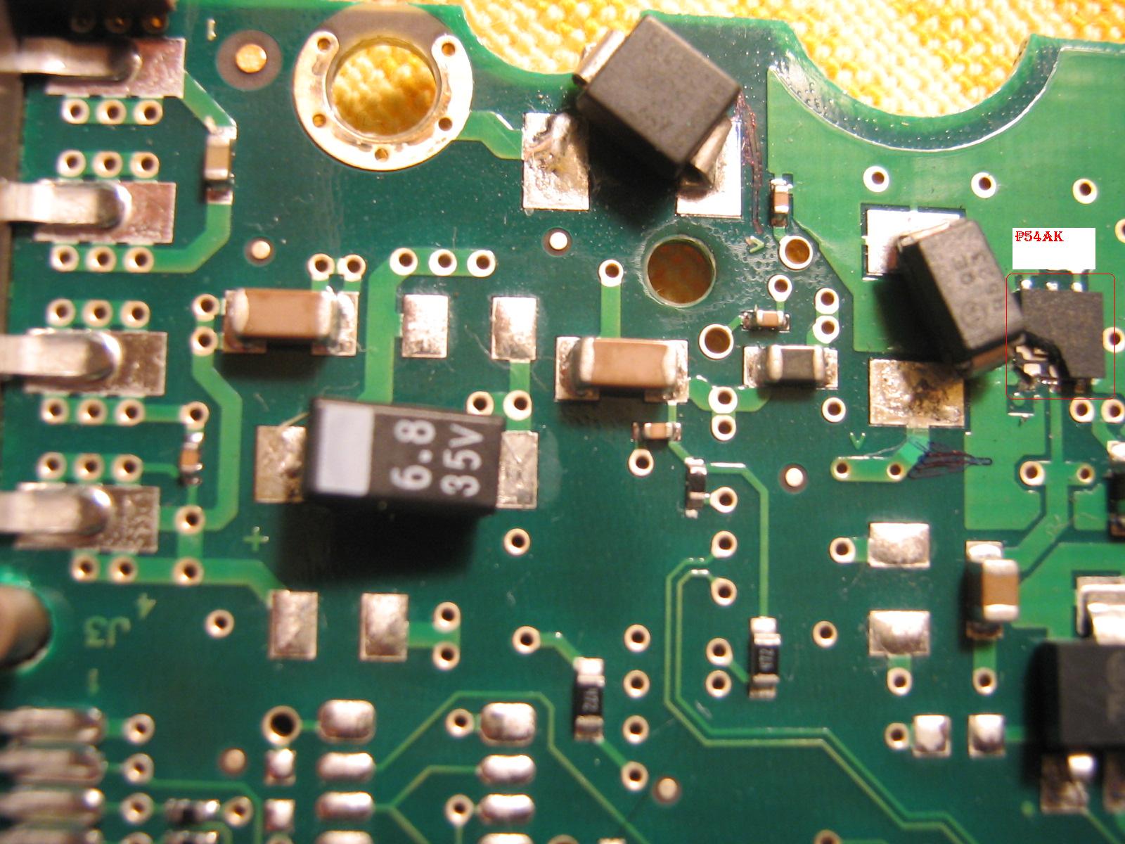

 Post subject: Datasheet "P54AK" of Fairdchild?
PostPosted: August 24th, 2008, 22:17
Joined: August 20th, 2008, 20:25
Someone has a datasheet of p54ak 8-pin device? (obsolete)
Please pm me if you have.
Thanks in advance,
Alienan

It's actually FAN 2011 but you cannot see it because that part is missing :)
Here is yor DS - http://www.datasheet4u.com/download.php?id=211910
It should be 3.3V power supply
